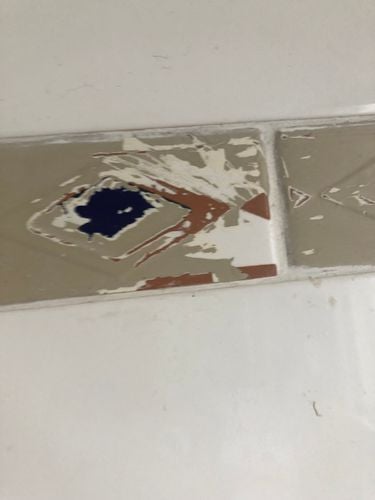

How do I remove paint from tiles in my bathroom. Half a tile just peeled off and I was inspired to remove the rest. I tried a scraper but this is not a valid method for me. I’m not sure what of paint it is . The tiles have a raised pattern on them so they are not flat. Advice would be welcome .

Chances are it's some type of epoxy paint designed for tiles. You'll likely need to use a chemical stripping agent to get the paint off, which will be a messy and potent smelling process. Depending on how many of these tiles need to have the paint removed from them, I'd advise considering painting over. If the stripper is really effective, it could make short work of the job, but in my experience, trying to remove epoxy paints is not exactly a fun process.
Make sure you use appropriate PPE gear like safety glasses and a respirator whilst working in a well-ventilated space.

Painting over them again wouldn’t work. I have no idea why they painted over them in the first place. But removing the paint sounds like a difficult job. Do you mean that even with the stripper it will be difficult to remove?

How difficult the removal process will be, depends on how well the stripper works, @RosemaryK. A little tip is to apply the stripper to the tiles and then tape down plastic bags over them to encapsulate the fumes. The stripper will be much for potent if it is confined like that. It might take a few applications to remove all the paint. Depending on the paint type, sometimes even with strippers, it can be a laborious job removing it.

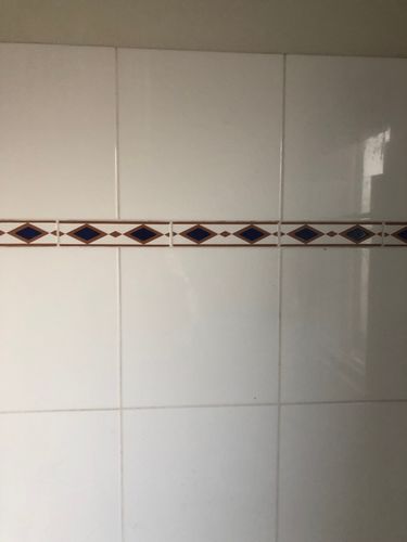

 so happy - it worked - polystrip with a paint brush - did a few tiles a time, just reapplied in the corners as it was a bit stubborn- otherwise so satisfying- you could actually see the paint bubbling up before your eyes. Thank you Mitchell !

I'm thrilled that worked for you @RosemaryK! Sometimes it can be a little bit hit and miss.
As you previously mentioned, I'm not quite sure why they painted over them in the first place. The tiles look far nicer than the brown/grey paint.
