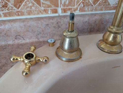

Hi Team,
My hot water tap won't properly close and leaks for this sink. Trying to access the spindle. Can someone please advise how to open/loosen the tap's base?

I propose using Haron 100mm Strap Wrench on the spindles cover base to turn it anti clockwise. Another option is to cover the spindle base with a thick rag and use a Craftright 250mm Multigrip Plier. Please note that the finish could get damaged if excessive force is used using the tool.

Hi @Laozer I agree on all suggestion points with @redracer01 If you go down the path of having to use multi-grips, then another type I have had good success with that has more leverage if you get a longer handle one is a Plumbers pipe wrench.
Multi-grips have more uses if you have to buy a pair over a pipe wrench and both will most likely cause damage to the fitting to get a decent grip.
Pipe grip from one side due to the direction of the teeth. Just open the jaws slightly larger than the grip point (suggest in the middle). Flip the wrench over if its not gripping.

A good pair of multi-grips such as these IRWIN All Purpose Locking Groove Pliers alongside a thick rag should do the trick.

Like the rest of the crew 🙂 I have used a Haron 160mm Strap Wrench to remove my taps. They were locked on solid and in the end I also used multigrips as I decided to change over the taps themselves. They bases were scratched in the process so if you are thinking of reusing the ones you have id make sure you have a decently thick rubber between the jaws and your taps and just work slowly.
