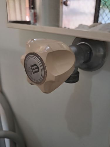

How to remove tap to replace washer?

Hi @rob88,
Thank you for your question about removing tap handles to replace a washer.

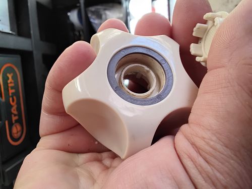

This style of tap will usually have a concealed lock nut just under the tap handle. You'll need the spanner tool that comes with this Kinetic Spout And Handle Repair Kit.
Have a look at the guidance and video in How to remove this tap handle?
This should guide you through the removal process.
If you run into any issues along the way, please don't hesitate to reach out.
DIYGnome
Becoming a Leader
Re: How to remove tap to replace washer?
Hello @rob88 that tap handle looks familiar, I fully suspect the retaining nut (or screw) is actually hidden under the handle's end cap which you will need to pry off (finger nails are usually sufficient), screws can be more difficult if corrosion is present OR the screw head is damaged, penetration oil (CRC, WD40, RP7) might help somewhat.
Once the tap spindle is exposed the O rings are replaced in the conventional fashion.
https://www.workshop.bunnings.com.au/t5/How-To/How-to-replace-a-tap-washer/ba-p/158637
