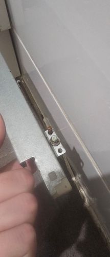

I haven't seen that mechanism in your pictures. Can you please confirm you have the Estilo 750mm Freestanding Vanity With SMC Top as that was the closest I could find?
Hi Mitchell,
Thank you for your message.
This picture shows side rails but the rails on this cupboard are underneath the drawer. The tabs are not visible on the drawer runners.
That is the vanity unit but I note in the pictures on the Bunnings site there is only one hole for the mixer tap but on our unit there are three for two taps and fawcet.

Hi Mitchell,
Thank you for this however it has been done. I think I have attached photos of this step.
I was very hopeful this suggestion would work but unfortunately it didn't. When the plumber returned last week he tried this as well as I had not put the screws back in.
It would seem the drawer cannot be removed. The plumber managed to access the breach at the back and replace the pipe.

So the info is correct on this thread.
There is a screw on the underside of the drawers holding the rail onto it and there is also a button with a gear that can be turned to lower or raise or can brute force lift the front side up and out as in the rear there are 2 hooks holding the back ends in
