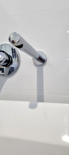

Hi Bunnings Workshop Team,
I am looking at replacing this bath tub spout with a hand shower but it won't come off after multiple tries. Is this mounted differently that I am missing something?

Hello @badmojo
I suggest running your fingers around the base of the spout and feel for a small hole. When you find that hole, you'll discover that it has a grub screw inside of it. You'll need an Allen key to remove the grub screw. Once you have the grub screw out, you'll be able to pull the spout out.
However, you'll find attached to your wall spout's outlet is a special spout fitting. In this instance, I suggest engaging the services of a licensed plumber to remove and replace the fitting with a standard threaded pipe. Due to its sensitive nature, removing and replacing the fitting is no easy task. If installed incorrectly the pipe could leak causing damage behind your wall.

Thanks @EricL for the response. I did look for that allen near the base but it is not there.
It is a different spout and tightly attached to the wall.

Hello @badmojo
If that's the case, I'm afraid it's time to call in the plumber. An experienced plumber might have an idea or two on how to dismount the spout from your wall. Worst case scenario is that it will need to be grinded or cut off from the wall.

Hi @badmojo You might have some luck using one of these rubber strap wrenches and grab the spout at the outlet recess to give a better grip and try turn it from there anti-clockwise. These shouldn't damage the chrome work.
And if your going to try a screwdriver at the spout end as @Dave-1 suggests, just first check there is no internal diffuser.

Evening @badmojo
One more suggestion You could use a short thick bladed screwdriver and put it into the spout and use that instead of a spanner or shifter. Main reason is less likly to scratch that chrome (broken chrome is sharp) but also to give torque in turning the spout. Like @EricL and @JoeAzza id probarly hit up a plumber first before this last resort. Cracking a tile or damaging the waterproofing isnt worth the pain to fix that as well.

Thanks @Nailbag . I did try a vice grip before as I did on other baths before but this one wouldn't budge. I'll try this rubber grip.

Thanks @Dave-1 . I was thinking actually of just connecting the hand shower to the spout with the diffuser but the thread seems to be non standard. The one I bought from Bunnings that I thought would fit wouldn't fit at all.
