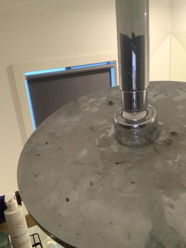

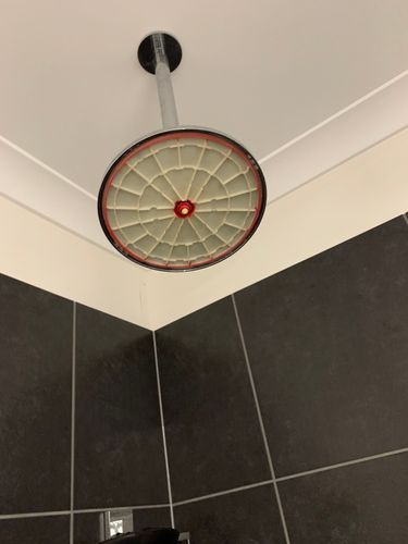

this is our rain shower and it was overflowing and not coming through the holes and I tried to remove it but the plate came off but the remaining part is still up there.
I am a newbie and I don’t know how to remove the shower head as it looks like a ball, could you please guide me with this please.
should I change the whole shower head or I should stick it with a glue?
how to remove the shower head to attach a new one?
I mean, what tools are used to remove this kind of shower head? It’s too high and it’s hard to remove without knowing what tools to use.

If you look closely, you'll notice that the shower head attachment has flat slots for you to insert a Craftright 300mm Adjustable Wrench. However, if they don't have flat slots, you'll need to grip the top of the shower head attachment and twist it anti-clockwise. Please make sure not to twist the shower arm.
I've placed an image below to give you an idea of where you need to look for the slots. I recommend changing the shower head with an Estilo WELS 3 Star 9L/min Chrome Round Shower Head. This is a common replacement head for ceiling-mounted shower heads. It provides the same rain-type shower feature that you currently have.
