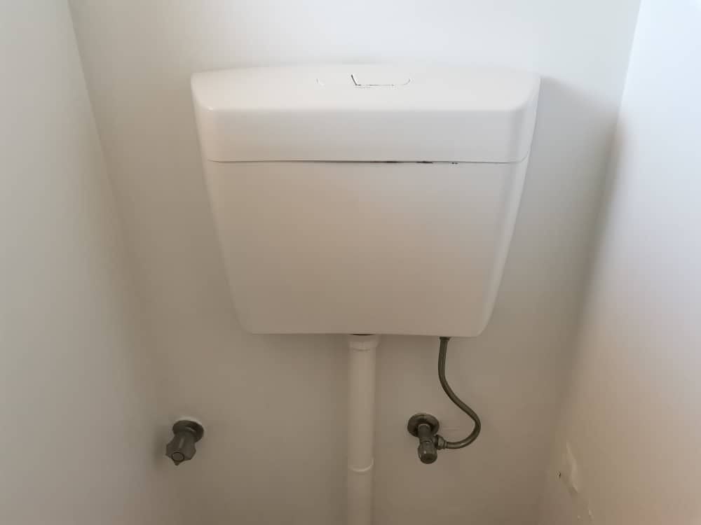

We have a Caroma plastic cistern for our toilet. We can hear water drip inside the cistern. We hope some can help to give advise :smile:
1. How do we open the cistern cover ? It seems hard to lift the cover and we are worried we will damage it.
2. What could possibly be causing the leak and whether we can DIY the repair.
Appreciate an advise on how to lift the cover. Thank you.
