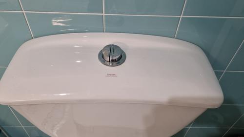

Hi All, I don't know how to remove the cistern lid on this 1990 Fowler toilet. I've tried unscrewing the circle around the button but the button moves with it and it won't turn. Not sure if it's jammed and am worried if I put too much force on it that I'll break it. Any ideas?
Hello @mekster
Welcome to the Bunnings Workshop community. It's wonderful to have you join us, and thank you for sharing your question about your toilet cistern.
You are on the right track with trying to remove the locking ring. However, the flush buttons have stuck to the locking ring and is preventing you from turning it properly. I suggest trying this method, hold on to the flushing buttons including the centre divider. Make sure your grip is firm, but not overly tight. Now use your other hand to hold on to the flat locking ring and turning it anti-clockwise.
It's important that the flushing buttons stay in place and not move as you turn the locking ring anti-clockwise. It might be slightly tight, but eventually you will be able to get it off.
Please make sure to wear proper safety equipment such as gloves and goggles when working on your toilet cistern.
Hi @EricL
Thanks for your advice. You were spot on. When I held the buttons so that they didn't move I could turn the ring quite easily.
Much appreciated.
Cheers
Mekster

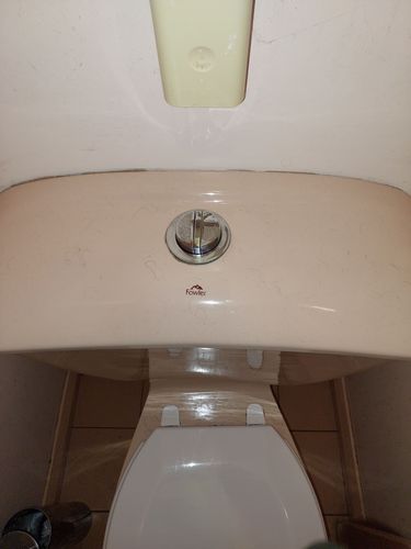

I have one of these peach coloured Fowler toilets from the late 1980s to 1990. There is small water leak from the cistern into the toilet bowl. What would cause this and are there spare parts available?

It might be possible to find spare parts for your cistern, but we'll need to see what's inside first. Would it be possible for you to post a photo of the inside of the cistern once you have the cover off? This will give our members a better idea of what parts are inside. We can then make recommendations on what alternative parts you can use to repair your cistern.

Please make sure to take several photos so that we can see the parts from different angles.
