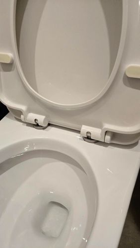

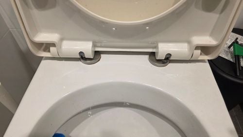

Hi, new in here.. Just want to ask and need a help on how to remove this cover from this toilet bowl. There is no screw or anything at the bottom just this things in here on top. The reason is, I need to fix my flat bidet on it. I hope anyone can help me out. Thank you.

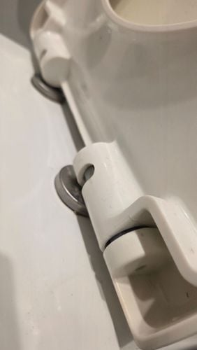

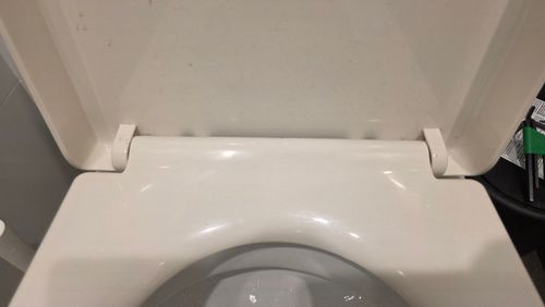

Your toilet seat cover might have a hidden release button. Your third photo shows the hinge of the toilet seat assembly with a small hole on the right-hand side. I propose getting an Allen key that is large enough to slide into the hole and pushing it in. If it is spring loaded the Allen key should move forward which will release the seat lock and allow you to lift the seat at the same time. You'll need to do the same thing for the other side

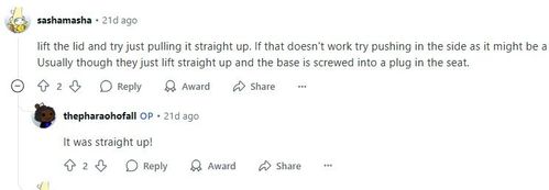

This looks similar to your seat.
https://www.reddit.com/r/Plumbing/comments/1n6tlmo/how_do_you_remove_this_toilet_seat/
Fingers crossed.
