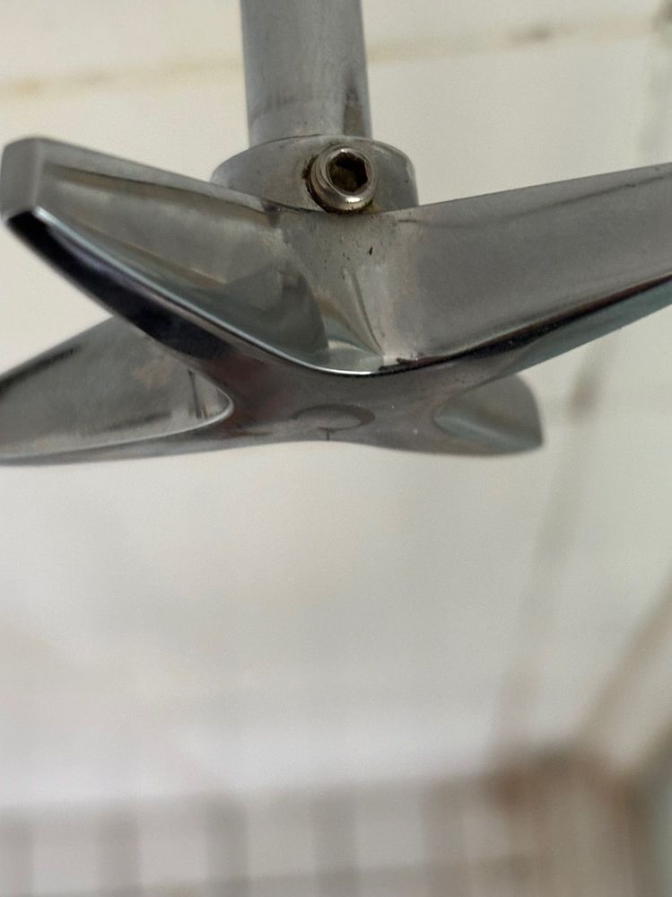

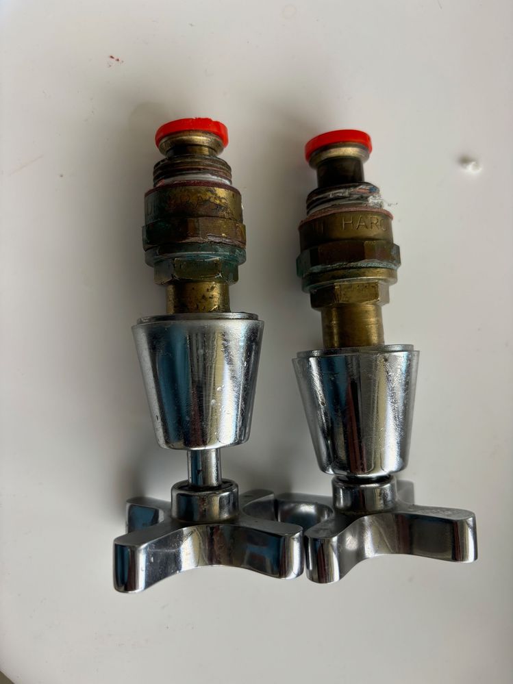

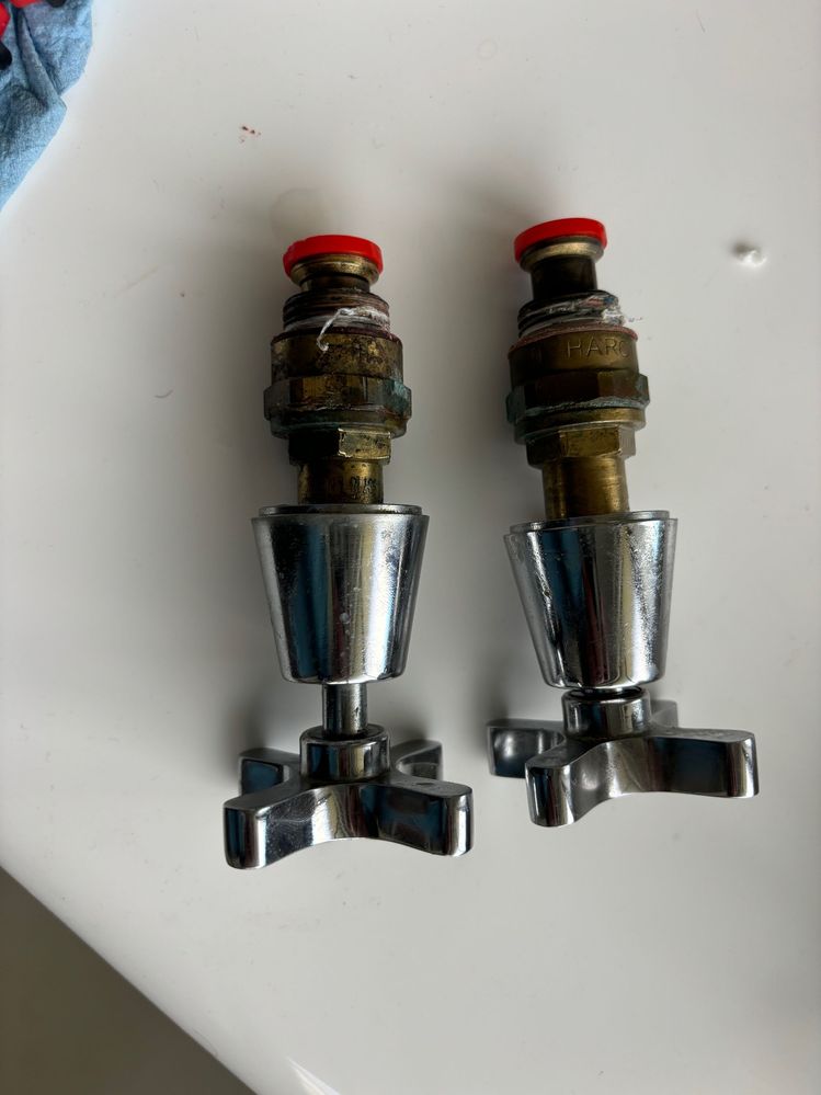

Hi All
I have got two different type of spindles one its knob has a hex screw when you undo the screw you can remove the knob, and others I don't know how to remove it the knob
I have attached photos for both
Re: Wall top shower spindle how to remove knobs
Hi @zillah,
Those look to have a nut under the handle head around the shaft. They require a special tool, which you'll find in this Kinetic Spout and Handle Repair Kit. In step two of this guide, you'll see it being used: How to replace a tap washer.
