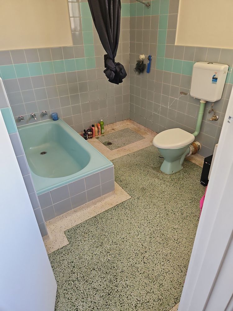

I have this Bathroom that I really want to get renovated in 2025. I am currently seeking ideas which won't cost an arm and a leg $5,000 or less

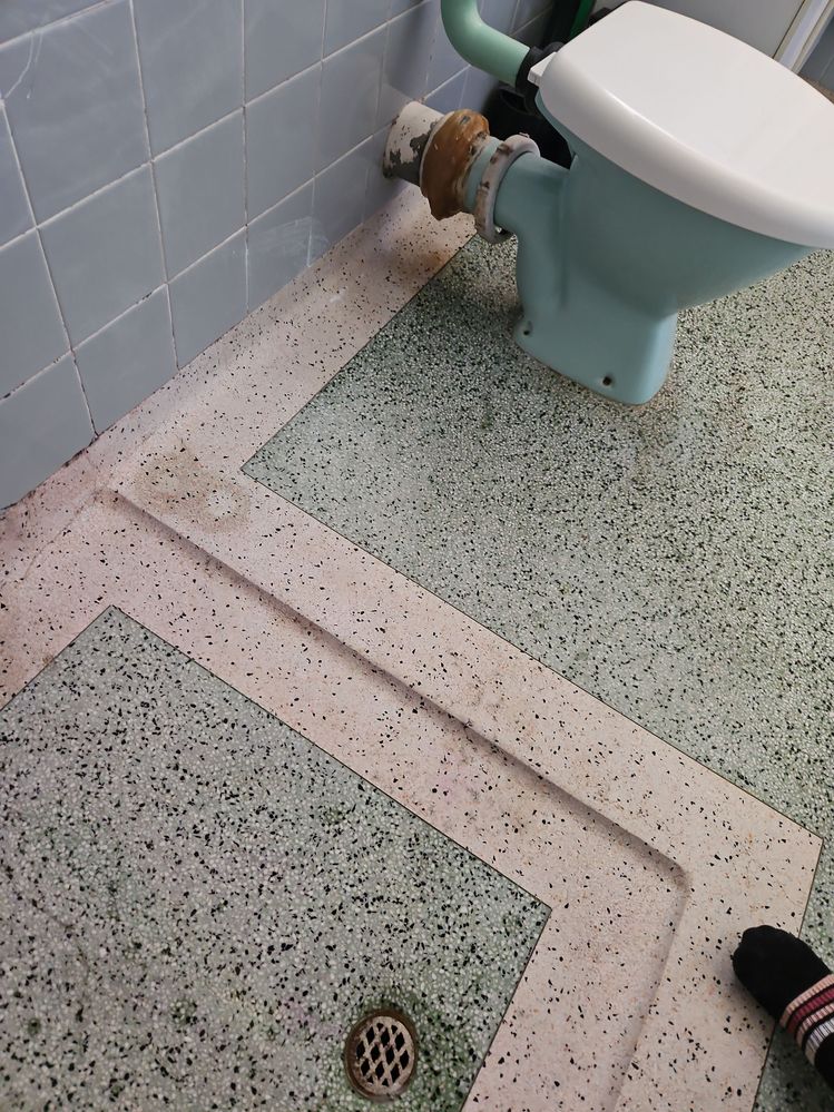

I wanna give most of it a go myself ,I've considered painting the tiles but I fear this will not last long. I've also got the tarrazo flooring  which I'm considering tiling over as I don't like the colour of it was plain black or white I would have keptb

That older bathroom  would have seam great in its day.

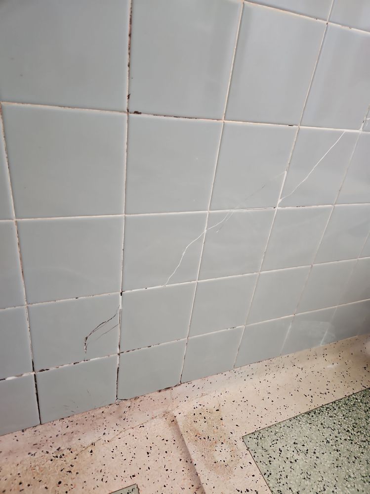

To save money The easiest way is to tile over the top of the existing tiles  I use an angle grinder to score the base tiles creating glue keyways.
But you floor has curved walls and curved shower  basin.
Maybe the shower can  be a prefab fiberglass base and  matching glass shower screens.

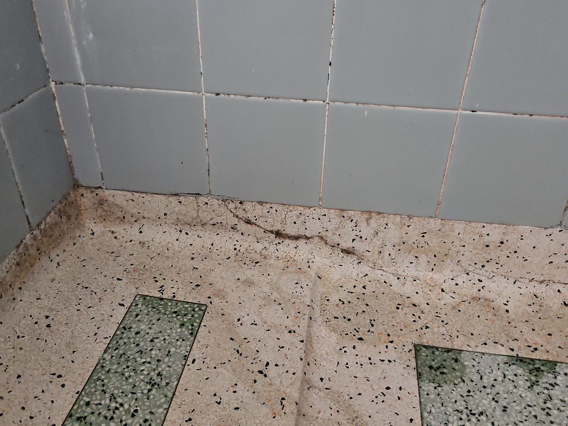

Start pulling tiles off the floor /walls will destroy any waterproof membrain and the under floor may need re surfacing.
You can  get some great closed back loos these days that old one an eye sore,
Baths  can be repainted  with an enamal like paint or epoxy paint more expensive.
So thats  just to start the ball rolling  see what others  say too,

To keep costs under $5,000, you might consider painting the tiles as a short-term solution. While it may not last forever, with proper preparation and quality tile paint like the Dulux Renovation Range, it can give the bathroom a refreshed look for a few years. For the terrazzo flooring, tiling over it is a practical option if you don’t like the current colour. Ensure the surface is clean and level before laying new tiles, and consider using large-format tiles to reduce grout lines and achieve a modern finish.
Other cost-effective updates could include replacing dated fixtures like taps, adding a new mirror or vanity, or updating the lighting to give the space a contemporary feel. These small changes can make a big impact without breaking the bank. You might also like to replace the toilet, remove or upgrade the bath and add a shower screen.

I just didn't want to go to the effort of putting in a new toilet just to rip it up in a few years to replace the floor hence why I thought I would try and do it now all in one go. So if I was to take the tiles off the floor and re-tile I would also have to put a new waterproof membrane? if the plumber is already taking some tiles off to change the location / style of tap would this too affect the waterproofing? Tiling over pre-existing tiles is they're and negatives to this? Obviously there is the huge bonus of not having any waste. Also do I need to worry about asbestos? The walls are solid.
Ive got in my head that I would like it tiled to the ceiling in with white tiles , tile the floor with large black tiles and install some sort of basic shower screen to prevent water splashing all over the floor which it currently does.

If you plan to remove the existing floor tiles @Knipe_AUS, you will most likely need to replace the waterproof membrane. Removing tiles can compromise the membrane, especially if it was installed over the original floor. When the tiles are removed, the old membrane might be disturbed, meaning it’s essential to reinstall a new waterproof layer to ensure proper moisture protection, particularly when tiling the entire floor.
If your plumber is removing tiles to change the location or style of the taps, it could also affect the waterproofing in that area. Ideally, any exposed areas should be treated and re-sealed as part of the renovation. You’ll want to confirm with the plumber whether they plan to disturb the waterproofing and if additional sealing is required after the tap changes.
Tiling over existing tiles is certainly an option, and as you mentioned, it saves you from the waste and effort of removing the old tiles. However, there are some things to keep in mind. The surface must be properly prepared to ensure the new tiles adhere well. In some cases, if the existing tiles are too damaged or uneven, it might be better to remove them. Also, you’ll want to check the adhesive and grout compatibility with both the old and new surfaces.
