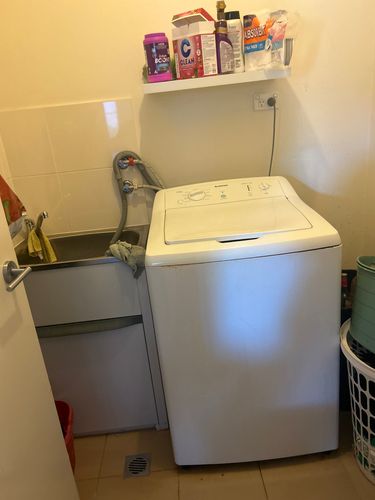

I have a very ugly laundry! Have a new washing machine being delivered soon. Front loader. The laundry in my home is behind a door with no natural light. If anyone has any ideas of how to make this room more workable I’d be so grateful.

Breakdown the laundry into areas that you feel comfortable working with.
New washing machine, and its a front loader means you could have a bench across the top. (remember to make the space for the washing machine a little large for when it is replaced in the far future)
Would you be comfortable removing the metal sink and installing a new one that fits in with a longer benchtop?
Lighting, Slimline batton LED or maybe look around at some lighting stores for a wider slimline LED fluresent style fitting to give the room a daylight glow.
This is just and example of the style I am suggesting for the lighting panel LED Panel Lighting (I have had a look at Bunnings but didnt spot an example)
Shelving, I have seen some really nice timber styles that Bunnings community members have come up with. i couldnt even think of where to suggest to look first!
I just searched for "Laundry shelves" and yeah soooo many ideas!
The last idea is to actually paint the floor tiles, This is what I will be doing in my bathroom sometime in the next year.

I would recommend you provide the dimensions of the room to @EricL as he often creates 3D renders for Workshop community members so they can visualise how to transform their homes. A little basic sketch that shows where the plumbing and electrical connections are is even better - if you can makeover the space without having to move the services it can save a lot of money on tradespeople.

My apologies for the late reply. While we are waiting for your laundry measurements, I've drawn up a possible layout for your laundry, please let me know if you would like to modify it, I'll be more than happy to re-draw it for you.
In the meantime, I suggest having a look at this discussion - Laundry reno with Kaboodle cabinets and benchtop by @theDIYedit. This is a well-planned renovation with room for a pantry and several cabinets. Lighting is provided by the LED strip at the back of the cabinets which I think can be applied to your situation.
My only other recommendation is to consider installing a skylight so that natural light will enter your laundry room.
