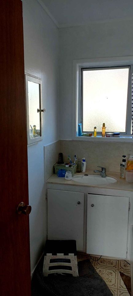

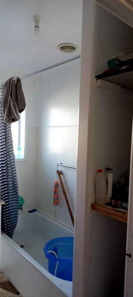

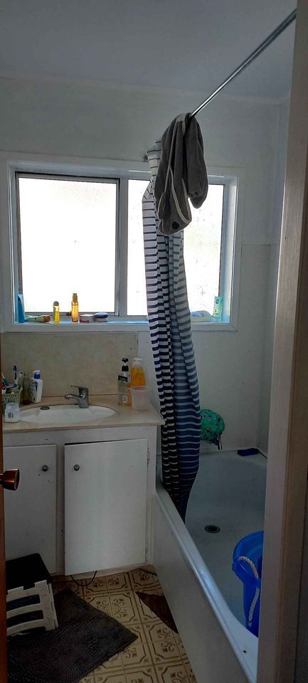

210 x 165 Bathroom Dimension. I am looking to renovate my bathroom.  Shower/Vanity is in my mind(no tub). Please let me know your opinion.

Thanks for sharing your bathroom renovation project with us. Can we please trouble you for a sketch of the layout of the room, complete with dimensions? It would help our members see what you are working with.
It would also be great to hear your goals for this project, and whether you have a budget in mind. This will help us determine whether you can simply perform a makeover or gut the whole room and start from scratch in a comprehensive renovation. Experienced Workshop member @Adam_W has shared a comprehensive guide How to plan a bathroom renovation that would be a good place for you to start.

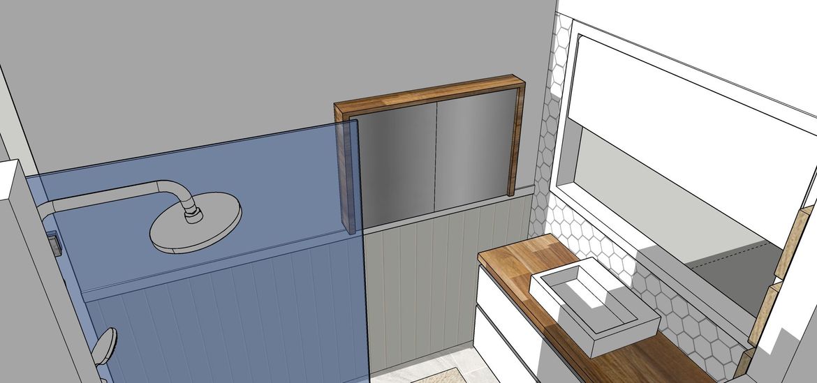

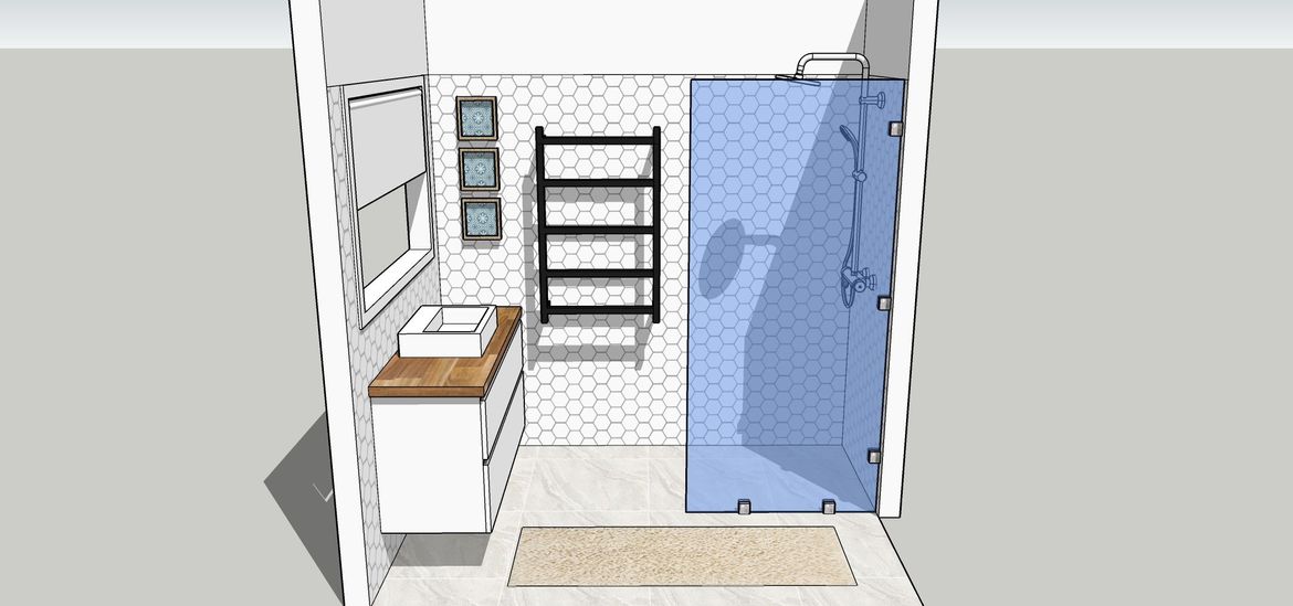

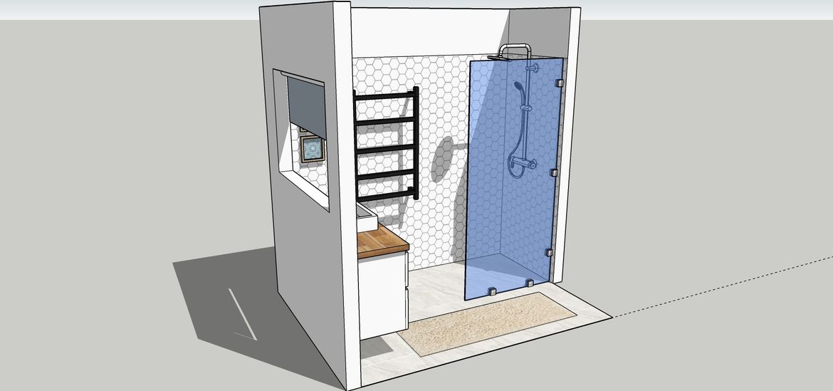

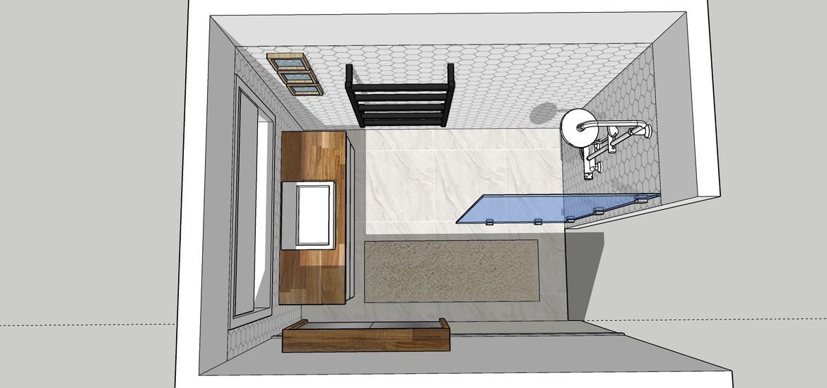

Thank you for sharing pictures of your current bathroom. Due to the limited space in the room, I've drawn your initial layout with the largest wall-hanging vanity cabinet I could find. Combined with a timber benchtop and a countertop basin this should be an affordable upgrade to your current vanity.
I recommend removing the built-in shelf near the end of the bath to free up some space to allow the shower to be relocated in that spot. I've placed in some Bellazza 60 x 60cm Crema Porcelain Floor Tiles and classic Decor8 Tiles 284 x 324 x 6mm White Matt Hexagon Ceramic Mosaic Tile for the walls. Please have a look at the sketch and let me know what you think. If you wish to see it in another configuration please let me know.

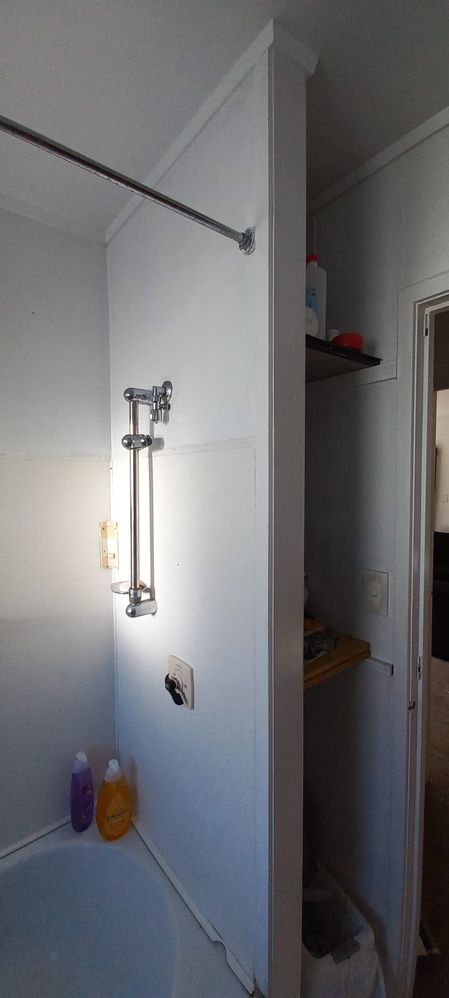

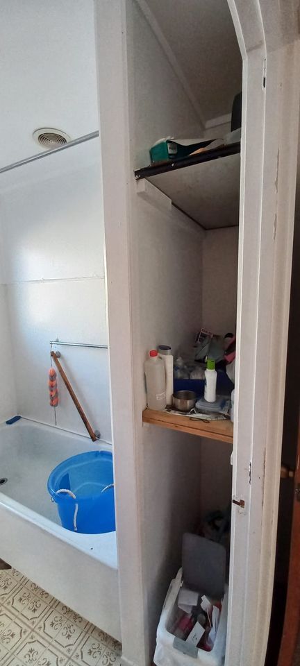

That's a nice plan & it fills the need. But I have a concern about the divider. Can we remove that?

It looks like @EricL's preference was for you to remove the divider/built-in shelf. "I recommend removing the built-in shelf near the end of the bath to free up some space."
From the photo you've provided, it doesn't appear that the divider contains a stud wall. If it's not a structural wall, then you should be able to remove it without issue. If you'd like to take a few more photos from a different angle, I trust our members will be able to confirm this for you.
Since this is a reasonably old bathroom, you should verify that there is no asbestos before starting demolition work. If there is asbestos present, you'll need to take safety precautions when working with it. Check out this Best Advice article on Where might you find asbestos in your home?

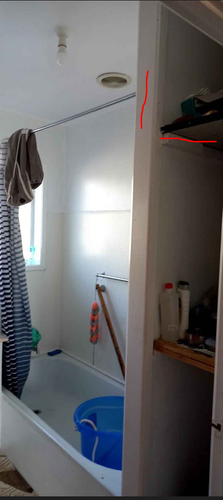

Please see some more photos. WhatsApp Image 2022-07-23 at 8.09.47 AM (1).jpegWhatsApp Image 2022-07-23 at 8.09.47 AM.jpeg

That partition certainly looks like it would be easily removed as part of a complete renovation of your bathroom. However, when removing any wall, it's essential to ensure that it isn't part of a load-bearing structure. If you are unsure, I'd encourage you to enlist the service of a qualified professional that can check for you.

Thanks, I am not planning to remove walls, but removing this divider was a big concern  (thanks for that @MitchellMc).
Do you have any ref for professionals who can check & confirm its this wooden piece is not load-bearing or not?

Typically, it would be a structural engineer or a builder that could assist with determining the structural nature of a wall. I believe this is a partition and not a wall, but I'd hate to recommend you remove it, and then there be issues.
