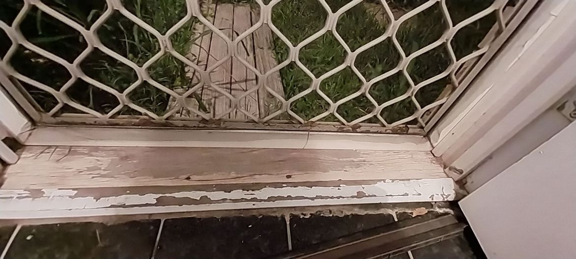

Unbeknown to me, the toilet has been leaking under the wall and into the external laundry door sill. It is now so swollen, the door is dragging across it when we shut it. Also, the intense storms over the past few days have meant that the sill has been wet from that as well. I tried to put on a new weather seal across the base of the door, as the other one had fallen off, however, the sill is so swollen, the seal will not slide underneath the stopper as it should. I don't know what to do. Will the sill return to normal? Should I sandpaper it to make the door fit again? Should I replace the sill, and how hard is that to do? I would have to do it myself...

Mmmmm Having a few looks at your photos and thinking how the timber became wet. In Ref to That last photo, is the door sill expanded upwards creating that gap? The timber dosnt look swollen, it looks like something underneath is pushing upwards?
Looking at the photos it looks like you have that piece that sits under the door that is now seperated from the tiles, (is the door base swollen? It dosnt seem to be)
You have that middle plate that is missing the paint from the middle.
and then there is another piece that is under the gauze door.
One way to to see what is happening is to remove that first plate that is raised. If you look closely you should be able to see some nail heads in the timber. (you could tap the timber gently with a mallet (so not to mark it) and see if the nail heads show up. Once you find them then you could lever that piece up and potentially see what is swelling underneath. Once you can see it, you may see the solution of post the pic here so we can have a look.

As to the sanding the wet timber, id hold off on that until it dries, Sanding wet timber will shred it (yeah done that as well)
Hi @Mickey362
Dave is right in thinking you need to fix the source of the leak first as its not just the door frame being expanded length ways and bowing. All the walls and frame work is under threat of dry rot with a constant water leak. Not tring to scare you as you have some time to fix loo first. If you fixed the loo already then please skip that comment part. Timber may dry out eventually and shrink or it maybe warped into that new shape.
But we do need doors to operate on a day to day basis and at the risk of shreadiing timber as Dave says I would belt sand or plane the door frame back into service so the door operates freely. Once the leak fixed timber will dry and a clean sanding can be done and repainted as you like.

Is the smaller trim piece at the front pulled away from the tiles, or is the whole door sill swollen, too? It appears that a small sloped trim piece at the front is causing the door to jamb. Can you remove that piece to inspect behind it?

I tried to slide some paper under the sill, but there is no gap there. I'm not sure what is pushing it up. The nails are about 3mms sunk into the wood. If I lever the piece off, can I put it back on again? Or replace it? Is it easy to do? I tried to 'fix' my garage door, and that cost me lots of money to 'fix' my fix! Now I'm not so gung-ho!

I can't slide anything between the wood and the tiles, so I suspect it is just swollen. Can I easily remove and replace it?

Door frames are made into a box shape and are inserted into a house frame and screwed in and then tiles and wall covering are cut into the frame edge. So No taking the lower door frame timber out is not super easy too do.
Some times when timer swells it also expands long ways and if it has no where to expand to it must bow upwards as it cant bow down as the floor is there.
The easiest solution is to sand or electric plan that raised timber lump to allow the door to close properly and repaint timber.

After looking closer at the images, perhaps this is part of the door jamb, but it appears that the jamb might have been modified. How badly is the door jamming? You could try sanding the contact areas down to create some clearance.
