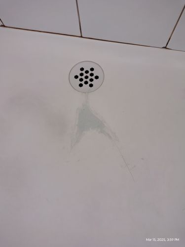

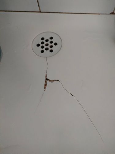

Got a small crack in my Acrylic shower base. I checked for any water bubbles or water weeping inside but it doesn't look like any of that. Need suggestions for DIY kits or DIY solutions for fixing this.

Is there any movement if you put weight on the crack?
If so, then a repair may not last very long as the shower base will flex and crack out any filler. If this is the case, unfortunately, your best option is to replace the shower base, which will require the assistance of a plumber.
If there is minimal movement, then you can use this PC-11 56g White Epoxy Paste to fill the cracks. Roll it into a thin sausage shape, then press it into the crack and strike off the excess. Once dry, lightly sand the epoxy paste to give a nice smooth repair.
As the paste is white, it may be fine without any additional steps, but if it stands out clearly, you might like to paint it using a fine craft brush.

You will first need to stop the cracks spreading you will need to drill 4 mm holes at the very end of crack line plus a 1 cm
This is how they start repairing aircraft noncritical panel damage.  The crack enters the hole and stops as the dynamics of the circle distributes forces evenly around the circle and has no exit point and there for stops the crack spread.
After that follow @JacobZ  s repair advice on patching the crack itself.
Ultimately replacing the base would be preferred and look the best and them you can add cement to bed the new base properly with no movement in future. But that may mean lifting shower screens and a whole lot more possibly
Repair options Continued
While your drilling holes consider drilling a 10mm hole at the major crack intersection for a different reason.
The 10mm hole will allow a caulking gun nozzle to fit through it I would pump a whole tube of silicon through it to form a bed to support the base from moving further assuming that the floor is close under it for the filler to fill.
Do all the above and
Using thick 15mm large format tiles silicone down (not tile glued) will distribute the people's weight across a larger area and should survive the weight and smaller flex.  So, silicone tile and silicone grout the insides of the floor once the floor is epoxide with no leaks, this will also waterproof somewhat.

Thanks a lot @JacobZ for your response and helping with right product. Bathroom floor looks really good. Is there any other coating I need to provide for any water damage over period
Re: Acrylic Shower floor crack repair
Hello @Nishantk
Thank you very much for that update, the repair looks very good. Since PC-11 56g White Epoxy Paste is waterproof no other coating is necessary.
