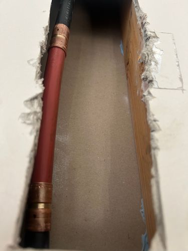

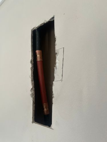

I have attached a pic and just chasing confirmation that the material I need to replace with is 10mm plasterboard and not a fibre cement sheet of some sort. The house was built in approx 2006 for context.
what would be the best way to repair the hole the plumber made to patch the pipe? It’s about 25 cm by 10cm

That is definitely fibre cement sheeting. Can you measure its thickness and let me know what you find?
If it is around 10mm thick, it is probably 9mm Villaboard.
Is it possible to get some photos showing to the left?
How far from that side of the opening is another stud?
Does that pipe extend down the full length of the opening?
The basic solution is to attach some timber around the outside of the opening, then cut a piece of fibre cement sheeting to fit the opening, screw it in place using fibre cement screws, then tape the seams with mesh tape, plaster over it, sand it, and then paint.
We'd need to see exactly how much space you've got to work with to decide on the best method of attaching the timbers, so once we can see the opening a bit better, I am happy to recommend a method.
Check out How To Repair A Large Hole In Plasterboard for an example of what is essentially the same process being done to plasterboard. The main difference is that you would use Wet Area Base Coat for the first coat.

Also there is no stud on left hand side that I can feel, the pipe was attached to the stud you can see before the damage was done

Considering there is no stud to the left and the pipe can shift inwards a bit, then I'd suggest you attach some 42 x 19mm DAR Pine Premium that runs vertically along the left and right side of the opening, using the fibre cement screws I mentioned.
You can then attach your piece of villaboard to these timbers and follow the process described above.
