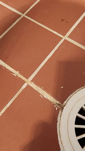

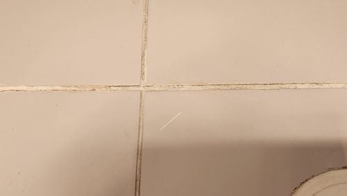

I just moved into a place about 20 years old. The two showers both need regrouting. I can see gaps between the grout and tiles, and missing grout.
I have removed grout with a grout hand saw before, and found the grout came up easily. However the grout in these showers are rock hard and wouldn't budge. What can I use to remove the grout?
The existing grout is lower than the tiles. Would it be ok to apply epoxy grout over the top of old grout?
I also need to remove old silicone. I've used selleys silicone remover and found it iineffective. Any other suggestions would be most welcome.

You can use a vibrating multi tool and half round blade would be good for grout removal. If the grout is solid thats fine just scuff it to give new grout some thing to bond to.
You want the silicon shower screen bead replaced ? The multi tool can help there too , some use a sharp scraper or knife, as well in the corners.
If you can steam clean the grout to kill off mold spores or at the least exit mold type cleaner then wash that off too.

Can I ask why you are keen on using epoxy grout? Typically, it's only used in some fairly specific circumstances and would normally be avoided unless it is necessary. You would have a much easier time applying standard grout and then sealing it to prevent staining, which will give you a similar result.
The only real advice I would have for you with the epoxy is to work within the manufacturer's guidelines, at the appropriate temperature, and do small sections at a time.

So what is going on I ask? 1 Evidence of Grout failing, 2 tiles popping off.3 water leaks This sounds like the tile glue having failed with a possible water layer under the tiles interfering with regrouting efforts , Any tile movement will trash the new grout is possibly where you are at.
So do you feel the tiles are solid? And or do they sound drummy? And leaks out the side of the hob?
Option 1 Well yes epoxy grout will glue them into place from the top down for a longer period of time.
Option2 if the tiles are really drummy is ideally they need care full lifting and re gluing .
This brings the membrane into question like you rightly asked. If it is damaged in side the hob base and sides region yes it will need to be replaced and that could explain any mystery leaks you have, But just that hob area. Is all I would do.
I have repaired leak points in ponds with 500mm of water pressure where menbraines fail normally around pvc pipe intrusions it just takes extra measures to repair, inside a hob is much easyier.
You @TH meantion grout going up and sealing the hob to the screen. Normally that job is best reserved for silicone as it is more elastic because that screen panel will flex if touched and it will crack away from grout easialy creating a leak in fact the grout may now funnel the water out wards/
