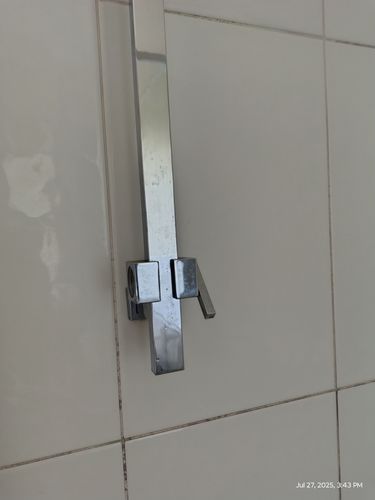

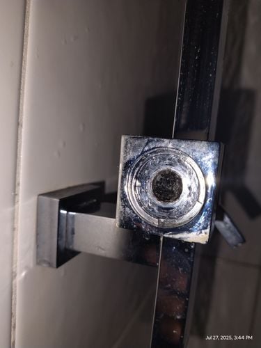

I've got a bar shower head installed (pic 1) however the shower head holder got broken and seems the washer got melted inside and not able to replace with new screw/washer ( pic 2). Any suggestions of how to fix it. I really don't want to replace whole shower head
Hi @Nishantk,
To have any hope of repairing it, you would have to start by trying to clean out the thread in picture 2.
You could use something like a flathead screwdriver to pick out the melted washer.
Once the washer is out, spray the thread with some CLR Bathroom And Kitchen Cleaner and give it a scrub with an old toothbrush.
The next step would be to essentially replicate what was there before.

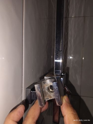

Can I trouble you for a photo of the back side of this piece? It may help to shed some light on what was there before.
I assume there was something like a rubber washer, then a bolt to connect the shower head holder to the bracket on the shower rail.
Do you have the old bolt?
Unfortunately, if you don't, it might just be a case of trial and error to find the correct size. If you could remove the bracket and bring them in store with you, there will be a thread tester you could use to find the diameter of bolt, and then you would just need to select a suitable length.
