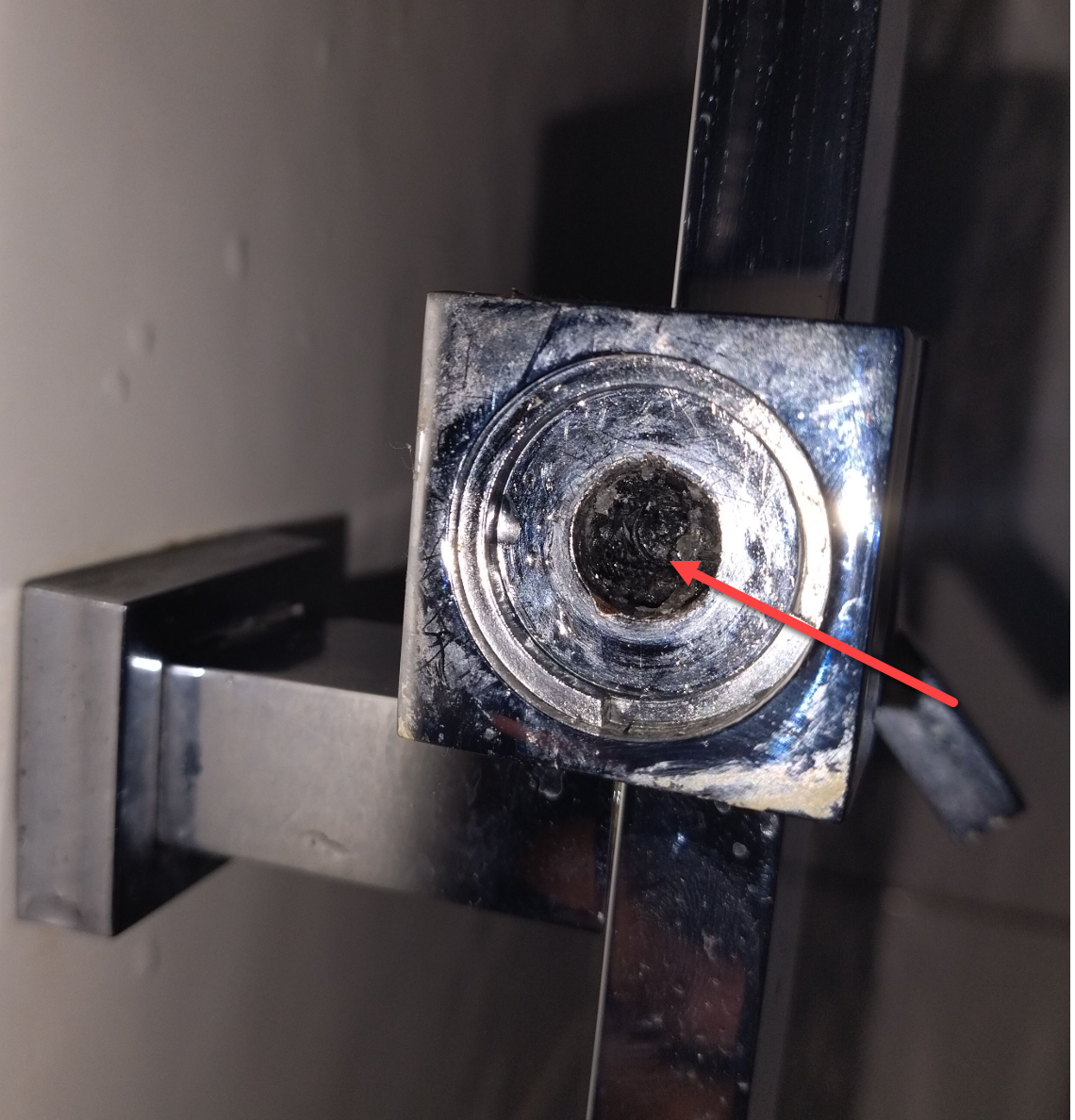

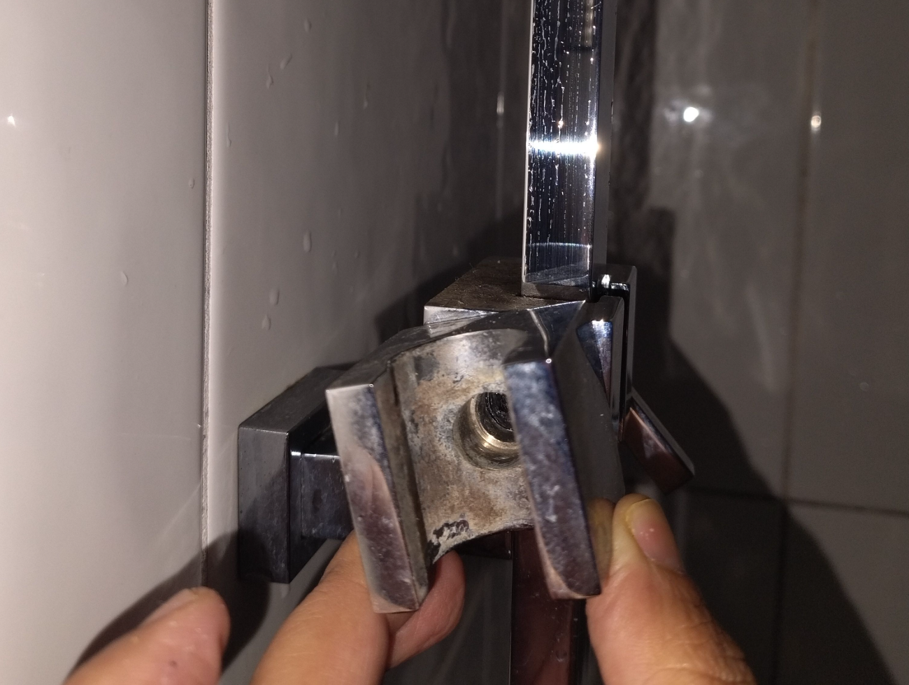

I've got a bar shower head installed (pic 1) however the shower head holder got broken and seems the washer got melted inside and not able to replace with new screw/washer ( pic 2). Any suggestions of how to fix it. I really don't want to replace whole shower head

To have any hope of repairing it, you would have to start by trying to clean out the thread in picture 2.
You could use something like a flathead screwdriver to pick out the melted washer.
Once the washer is out, spray the thread with some CLR Bathroom And Kitchen Cleaner and give it a scrub with an old toothbrush.
The next step would be to essentially replicate what was there before.
Can I trouble you for a photo of the back side of this piece? It may help to shed some light on what was there before.
I assume there was something like a rubber washer, then a bolt to connect the shower head holder to the bracket on the shower rail.
Do you have the old bolt?
Unfortunately, if you don't, it might just be a case of trial and error to find the correct size. If you could remove the bracket and bring them in store with you, there will be a thread tester you could use to find the diameter of bolt, and then you would just need to select a suitable length.
