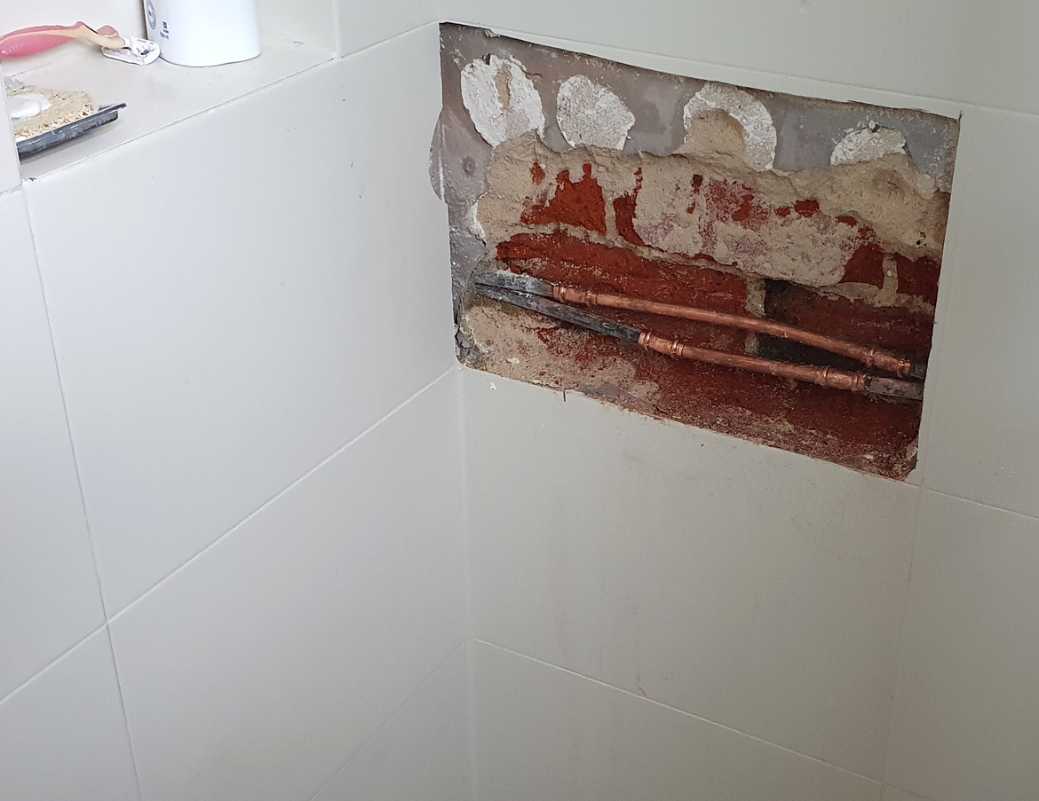

We had a burst pipe in the shower wall repaired by a plumber, and I need to replace the tile removed (and another one that was damaged). I just wanted to check that I haven't missed any steps. What I'm think of doing is:
1. The pipes run through a brick wall, so I'm assuming I first need to fill in the hole with some quick set mortar and skim coat it with a product that can be tiled over (e.g. Lanko 136 Rapid Patching Mortar).
2. Apply waterproofing membrane (e.g. Crommelin Shower Waterproofing Membrane). I assume I don't need to use waterproofing tape as well as there are no joints to cover.
3. Apply tile adhesive and tiles.
4. Apply mortar.
Am I missing anything? Given I am only replacing two tiles, do I need to do anything special at the edges where the existing tiles are?
