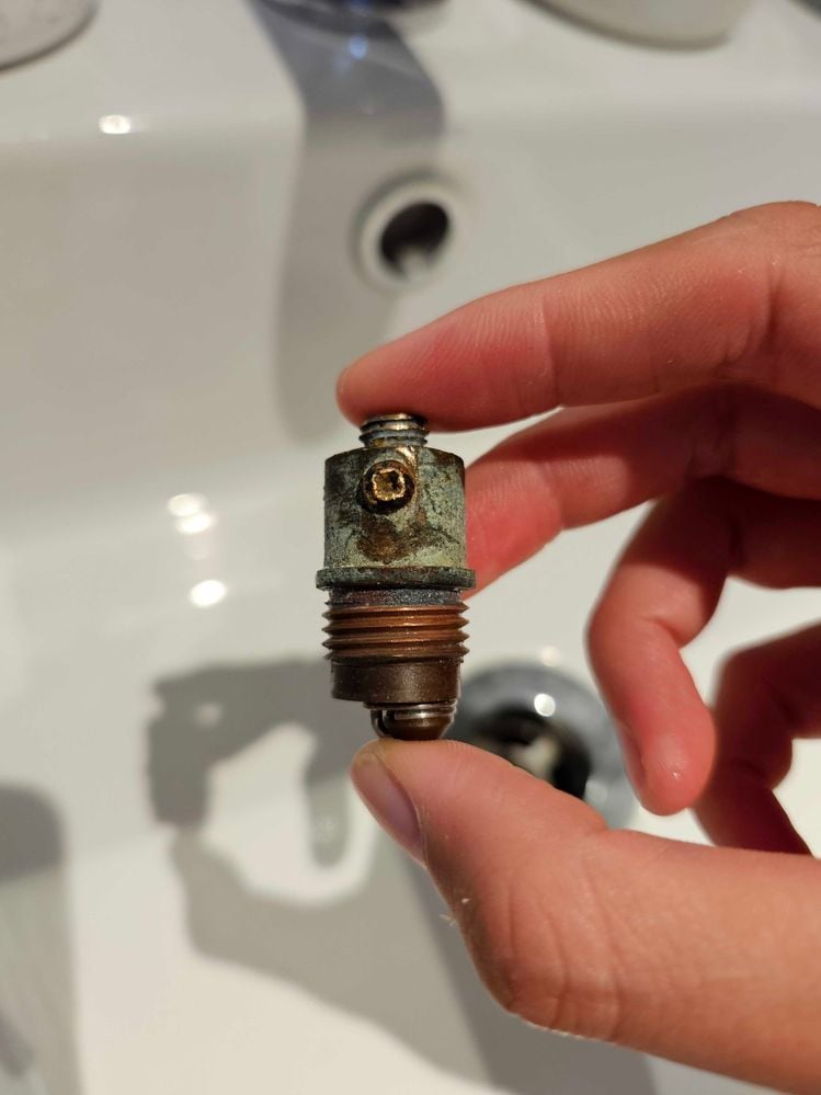

Hi all,
My sink's pop up plug mechanism has stopped working and I tried to lubricate it, did absolutely nothing.
So I have been searching the internet to find a replacement, couldn't find anything like mine. They are all too long and won't fit my sink waste...
I hope someone here is able to help me. Thanks in advance. The brand of my sink is Caroma, had no luck on their website either.
I have attached a photo of the tiny plug: 20230217_132328.jpg

Hello @EmmaWu
Welcome to the Bunnings Workshop community. It's fabulous to have you join us, and thank you for sharing your question about your pop-up plug mechanism.
If you are keen to do a D.I.Y. restoration of your pop-up mechanism, I suggest getting a small plastic container and filling it with cleaning vinegar. The mechanism must be fully submerged and left in the vinegar for at least 24 hours. I recommend trying to press it and see if the spring release works and the pop-up piston comes out.
However, if the spring release does not work, I propose dismantling the pop-up mechanism by removing the locking screw at the side of the piston. It's important to keep your finger on the piston so that it does not fly off when you remove the locking screw at the side. Using both hands carefully allow the piston assembly to rise and come apart.
Once you see all the parts make sure to take a photo so that you'll remember how to put it back together. Using an old toothbrush and the cleaning vinegar try to remove as much of the mould and calcium deposits that has attached itself to the interior body of the mechanism. Use steel wool for the more stubborn deposits that won't come off.
Once you've given it a thorough clean re-assemble the pop-up mechanism and spray it with WD-40 150g Specialist Anti Friction Dry PTFE Lubricant. Make sure to test the piston function to make sure that it will still lock itself in place. But in case of catastrophic failure and the piston can no longer be re-built, I propose changing your old pop-up set with a new plug and waste.

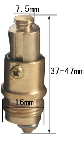

Try searching for: Talea Washbasin Drainer Inner Core Part 37-47mm
Re: How to replace Caroma sink pop up plug mechanism?
Hello @wilsoff
Welcome to the Bunnings Workshop community. It's wonderful to have you join us.
Thank you for sharing your knowledge and experience with the community. Let me tag @EmmaWu to make them aware of your suggestion.
