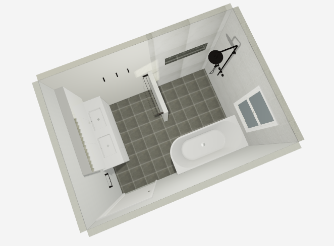

We are currently planning / thinking about remodeling our main bathroom and we are looking at moving the vanity and reusing the currently vanity floor drain and water pipes for the new freestanding tub, both drains are 40mm - is there any issue to do this ?
Also where the new location of the new Vanity is going is on an internal wall that doesn't have any waste or water pipes, am i allowed to run the 40mm waste pipe horizontally through a stud wall to the outside of the house where i will get the plumber to connect it into the external PVC drains (this is a 40 yr old house)
Below is the proposed design for the bathroom

3. Proposed Design:
- Your proposed design looks promising. Ensure that all new plumbing connections are accessible and maintain the required clearances for maintenance and functionality.

It's great that you've received great advice from @PlumbMaster-Zee. Just to add to the suggestions made, I recommend speaking to your plumber first and show them the plans you had in mind. You can still save money by doing all the hard work such as concrete cutting and re-tiling.
But it's important that the plumber approve where the waste pipe will travel and where the water source can be diverted to as they will be aware of the rules and regulations of the local council regarding plumbing work.
For example, you've placed your shower at the far end wall near the window, the practical diversion to provide water for your new vanity location is to run the pipework in the ceiling cavity and run it down the other wall. It is a much better way rather than drilling into your stud wall and weakening its structure.
I don't see any hindrance with your new bathroom layout, and I think it's an excellent use of space.

Im just wondering if your mockup is to scale? The bathroom door looks like it wont be able to open all the way?

Thanks for your reply, the drawing it to scale and the hinged door will be removed and changed to a cavity slider as the hinged door would swing and hit the vanity unit.
I have since spoken with a plumber and i will frame out the wall that the vanity waste pipe is going to run along to avold cutting into the wall studs
