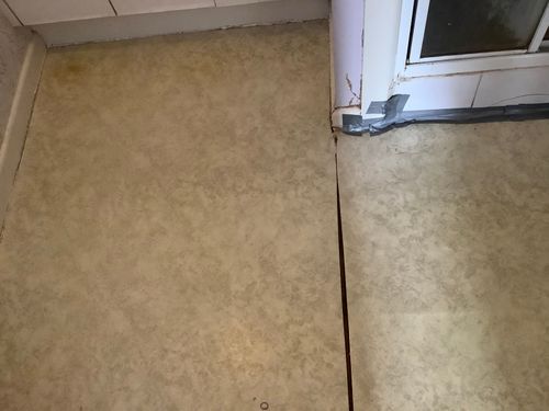

563B93F1-D12D-4B2F-B6F0-1D40088797BA.jpeggap beetween shower door likely issue of water at bottom coroner ...i suspectgap beetween shower door likely issue of water at bottom coroner ...i suspectno wet or damp but not sure since when wood color is like thatno wet or damp but not sure since when wood color is like thatshower baseshower base
added few photos
thanks for reply.
will try removing vinyl floor but worry if unable to put it back to avoid further damage. i couldn't find rotted wood(just damp might be due to gap between vinyl where wood is exposed) under vinyl but found only near shower coroner (just below where shower door gets closed).there is gap when door is closed (attached photo)and most likely water spilled out from it during taking shower.
might try to get to know how much damaged wood is and cleanup/remove temporary tape/silicone etc to find exact damage during weekend. As in photos didn't found any damp when checked below shower(house on stumps)

The first thing I notice from your additional images is the dark water staining marks under your floor. All those dark marks are from water seeping through the floorboards. Due to the amount of staining, I suspect there is a leak, and it's not just from occasional splashes of water escaping over the threshold of the shower.
I believe you are on the right track by conducting a further investigation. If there is a leak within the shower tray, you'll need to have this fixed.
Keep us updated, and let me know if you find any cracks once the silicone has been removed.
