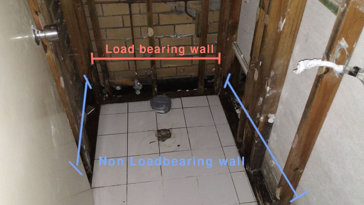

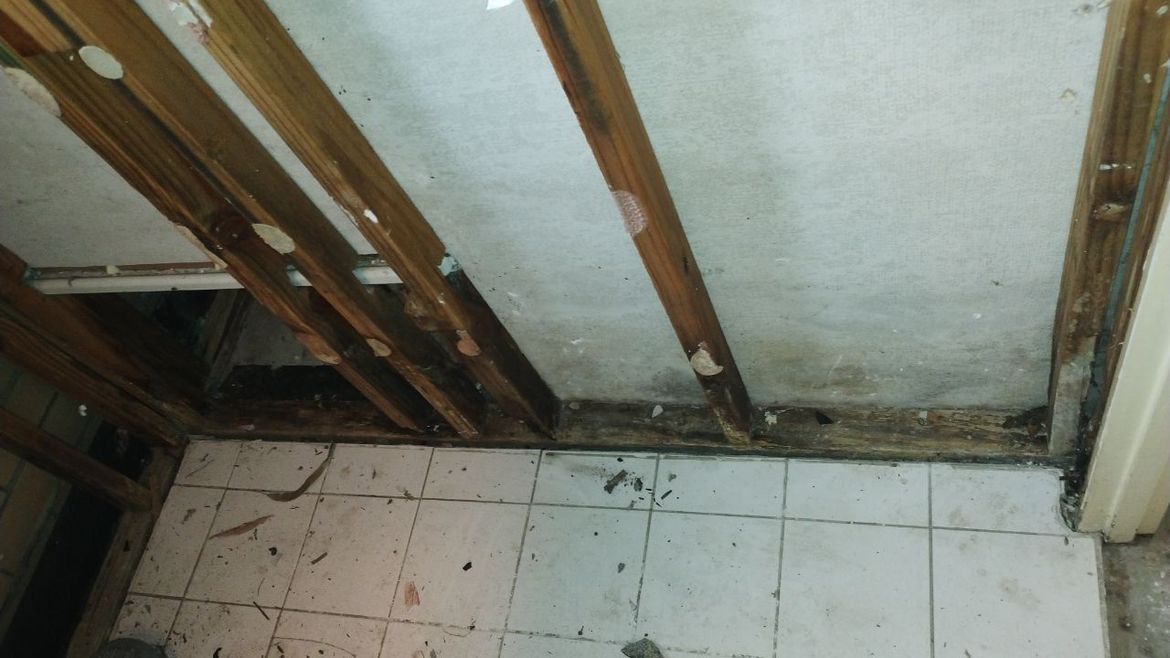

Hi. I have water damage in the walls of my toilet room. The leak has been addressed. But it has caused damage to the bottom plate and bottom of the studs. I need to replace the bottom plate and bottom half of the studs. The wall in question is a non load bearing wall. There is also a load bearing wall that was also damaged but i will hire a tradesman to fix that small section. I can not afford to pay a tradesman to do the whole thing which i why i need to tackle it myself. I have checked with local council and have discovered I can do the repairs myself without a permit.
house is a brick veneer build in the early 90's on the Gold Coast.
I need to know whats the best way to remove the bottom plate ?
I also note that the bottom plate does not seem to be bolted to the concrete slab below.
toilet room in questiontoilet room in questionThe wall that i would like to repair in questionThe wall that i would like to repair in question

On the condition that you've had your wall assessed by a registered builder and that they have confirmed that it is not a load bearing wall, I propose rebuilding the entire stud wall. But if it has not been inspected by a builder, I propose holding off on the demolition and having it properly assessed first.
Looking at the photos you've posted, it appears that the bottom part of the studs have been damaged by water as well. I don't recommend recycling any of the timber studs. If the bottom plate is glued down, I suggest using a Craftright 380mm Wrecking Bar to lift it off the floor.
Before you begin any demolition works, I highly recommend taking accurate measurements of the existing stud wall along with any channel cuts made into them. This will save you time and make it easier to recreate the stud wall.
Let me call on our experienced members @Nailbag and @Dave-1 for their recommendations.

"I propose rebuilding the entire stud wall"
thats not really on the cards. The wall on the other side is a bathroom wall. That would then cascade to the entire bathroom to be stripped out which is not in the budget.
Two walls in another room with the same damage were repaired by a registered builder and the effected studs were cut approx 600mm up from the bottom plate. the stud was then sistered with another stud going from the bottom plate up to about 1500mm. (not the full height of the wall)
I would like to recreate the same effect and wanted to know the best way to begin by removing the bottom plate.
good call on the wrecking bar. ill pic one up tomorrow

Hi @joshy1 I do agree with @EricL that if it's possible to get the load bearing wall done first as it may impact how you start on your sections of work. Plus you could take the opportunity for some free advice while the builder is there?
The bottom plates may have at least 1-2 concrete nails through them. But once the plates and studs are cut you can pry them up pretty easily with your new wrecking-bar. Though I would recommend going for a longer one for a few extra $ as the extra leverage will make the job easier. There is also a chance being short length walls you don't find any nails at all.
If you have a reciprocating saw, then these flush cut blades will cut the plates flush to the concrete. Otherwise a short sharp hand saw will work just as well. Keep the saw as horizontal throughout eh cut as possible to avoid hitting the concrete. Then go nice and slow just as your break through so not to damage the teeth.

That's excellent advice coming from @Nailbag. It's definitely worth getting a larger wrecking bar, my only recommendation is to make sure it has a sharp edge that will bite into the timber when you lever the bottom plate up. Plus, it's a fantastic idea to get the builder in to do the load bearing wall first and getting some free advice.

Now that is a decent sized job. I totally agree with @EricL suggestions about redoing the wall. One reason is if water has damaged the studs up halfway then there is a fair chance there is water/moisture in that plaster. It may be more expensive in one way but doing the overlapping and then having to come back to the plaster issues may be a false econommy.
How many walls do you have that sistering fix in? I "know" in my mind that its a way to repair and at the same time I dont 100% trust it. 😕
The pry bar and a saber saw would be your best friend in removing the base plate. Id definenty get the wall assesed by a builder for structual support . Id also support the top with agriprops while you are working in the area. Last bit I would suggest and I am not sure if its the wisest but id replace half the baseboard, do the sistering you suggest and then once done do the other half of the wall.
