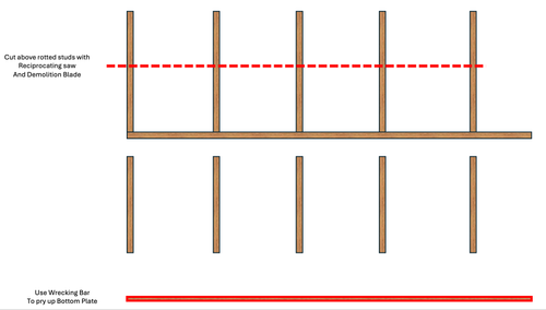

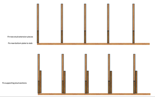

Hi @joshy1 theses are the steps in order to produce the same result as the frame thats been repaired by the carpenter that may make more sense.
That aside, it's worth noting that I can assure you from past experience that the cost of materials to replace entire studs and bottom plates is negligible compared to gap filling and fixing support timbers. The time to build makeshift repairs is actually longer than to install news ones.
and either method is complicated as @MitchellMc with the wall with one side is still cladded. This would need to be removed to with either repair method.

@Nailbag, If you cut the studs like your drew in your picture then the wall is just floating in mid air. dont you need to support it up somehow ?

Re: How to replace bottom plate of stud wall?
Hi @joshy1
Correct, but I was only showing how you would make all the cuts needed to then copy the way your builder had don't in the repaired room as you mentioned wanted to repair the toilet wall. But, it's not how I would do it as I would replace the entire wall.
