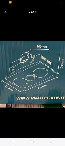

The exhaust in my bathroom is a 3 in 1 'Ringgrip' brand - no longer available. Cover dimensions are 43.5cm by 26cm. Would a 'Martec' 3 in 1 be a suitable replacement? Photos are of current old ceiling fan & box of new Martec 3 in 1.

Ultimately, you are going to require the assistance of an electrician for the removal and reinstallation of the new unit. They will make the final call, but it does appear like it should work based on the size of the face plate. If necessary, they can always make the hole larger to accommodate.
Assuming you have enough of a cavity to accommodate the 205mm depth, then the Martec 3 in 1 appears like it will work.
