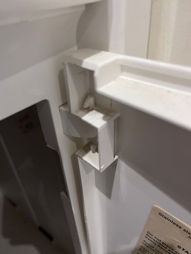

Hi, one of my hinges on my everhard laundry tub door is broken. Are these ones still made?

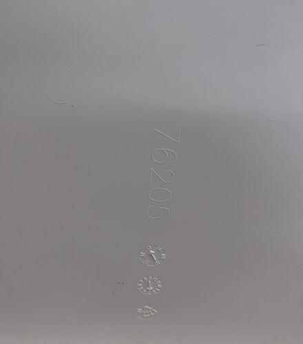

Knowing that it is Everhard is a great start, but if we can narrow it down further, that would be great. Is there a model number on that label I can see at the bottom right of your photo? If so, what is it?
A photo from further out showing the whole tub would likely also help.

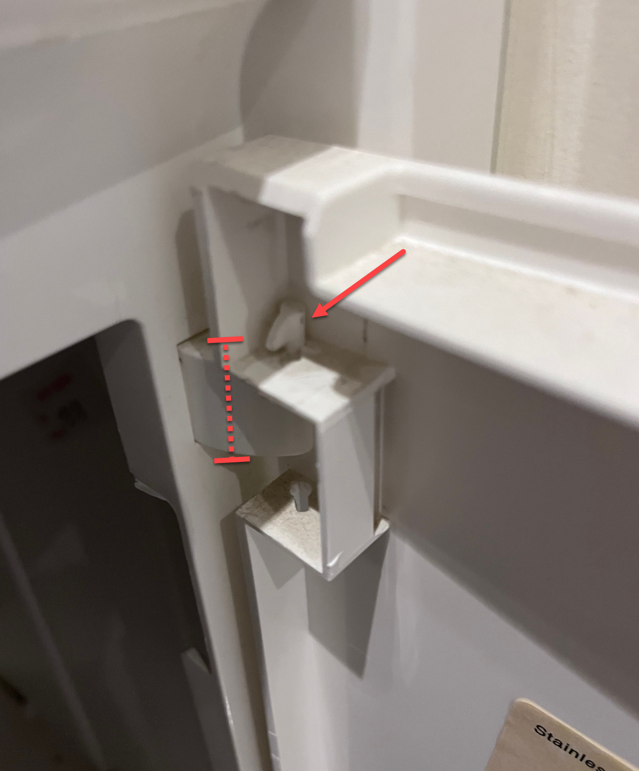

Can you also confirm what exactly is broken? Is it this pin here?
Once we can work out a few details, I would be happy to get in touch with Everhard to confirm the part can be ordered.

 Hi Jacob, thanks for your reply. This is imprinted on the inside door as there was nothing on the sticker. And yes the pin has broken on the other hinge. Thanks for your help.

I've spoken with the team at Everhard who have helped me identify the part.
The part number is 76201 - Polymer Cabinet Door Hinge.
You can give this information to the Special Orders team at your local store or our Spare Parts team. They will be able to get you a price and place the order for you.
