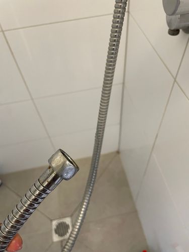

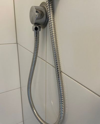

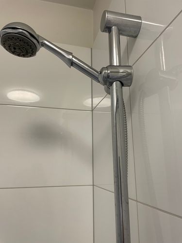

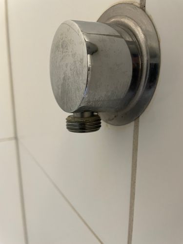

The shower head in our bathroom is a very old one and it’s leaking. I wanted to change by myself, can I find this type in the Bunnings? Please advise . Thanks in advance.
Re: How to replace leaking shower head?
Hello @viky
Welcome to the Bunnings Workshop community. It's sensational to have you join us, and thanks for sharing your question about replacing a leaking shower head.
Thank you for sharing those photos of your shower head assembly. It appears that they are standard sized fittings, I suggest having a look at the Estilo Chrome 3 Function Hand Shower & Connector Set. It is technically a wall mounted set, but the hose and the shower head will work with your existing shower set up.
It is possible to purchase a shower head and shower hose independently, but the set I suggested is best value for money. A multifunction shower head by itself will conservatively start at the $50.00. Whereas the Estilo set already comes with a multifunction head and a hose.
However, if you prefer a different set, I suggest bringing your old shower head and hose to the store and compare it with the new one you'll be getting.
I also suggest having a look at this guide - How to change a shower head.

Got our shower head replaced yesterday. Click and collected and installed it. Much appreciated for all the experts who took time to answer my questions. Thanks heaps again. @EricL @MitchellMc
