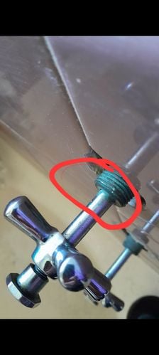

Hi, tap in 50 yr old home is leaking to the extent where the water meter is now continuously running. I’ve removed the handle but the part circled in the image doesn’t budge with an adjustable wrench - unsure if I don't have enough strength but also scared about breaking something and not being able to stop the water when I turn it back on. What’s the right tool for this ? Name of the tool and pictures + instructions in your response would be helpful. Thanks heaps!

Once you have removed the tap handles, I suggest using any of the following tap spanner sets:
I also suggest having a look at this guide: How to replace a tap washer
If the provided handle is not enough to generate torque, the tap spanner can be turned using an adjustable shifter or a plumber's wrench. Should the spindle housing turn accidentally, and a leak occurs your first step is to turn your mains water off to stop the leak. You must also be prepared to do an emergency call out to a plumber. They will then remove the broken spindle and replace it with a new one.

I suggest looking at these items - Craftright 300mm Adjustable Wrench or the Trojan 250mm Pipe Wrench. Either of these wrenches should work with the tap spanners.
