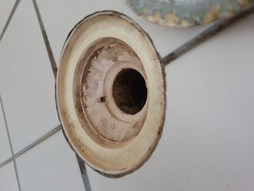

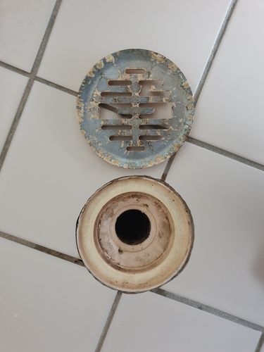

Hi there,
We recently bought an early '90s house in Brisbane and the plastic shower drain grate is broken. It doesn't seem to be a "standard" size however, being about 11cm. The shower floor grates I've looked at on the bunnings website and elsewhere online appear to be 10cm for the actual 'grate' part and the outside fitting with the tail is approx 11cm. That would be fine, however the floor drain itself slopes inward and therefore the tail part of the fitting won't fit inside the existing drain pipe.
Is there a solution for this that doesn't involve replacing the whole thing, ie. getting a plumber out to remove the old floor drain and putting in a new one? Would like to avoid that if possible as we've had them out to do so many things recently and I'm a bit over it to be honest!! At the moment we're just keeping a silicone one on top of it so that we don't have to see it...
I've attached a couple of pictures. Apologies in advance for the grossness - hope nobody is eating!

Hello @krunchfrog
Welcome to the Bunnings Workshop community. It's wonderful to have you join us, and thank you for sharing your question about your shower waste.
That particular waste fitting was very popular back in the '90s. Due to its age, it's now very difficult to get spares. I recommend bringing the top cover to the store and try to match it with the Kinetic 100mm Chrome Plated Round Floor Grate. The grate cover is very close in size to the plastic cover but is not a perfect match. It's an option that lets you keep using the shower without having to take the shower waste apart.
One other method to duplicate the cover is to use a Holman 100mm DWV PVC Round Floor Grate. You'll have to modify the grate using a grinder to remove the excess plastic. But once you have the correct shape it should fit in neatly.
Please keep us updated with your progress, we look forward to seeing your shower waste repaired.
Hello Eric, thank you very much for your reply! I like the sound of your second suggestion - I could get one of the chrome-plated brass covers that is the same diameter as the old grate - the drain pipe thing the grate sits on tapers in quite a bit so it won't fit depth-wise, but I could get my husband to grind the tail down until it fits. Would that work do you think?
Thank you very much!
Hello @krunchfrog
At this stage of the repair, I recommend giving it a go. If you can grind the tail down and make it fit, you won't have to worry about breaking the shower grate cover for a long while.
Please keep us updated with your progress, we look forward to seeing your grate cover repaired.
