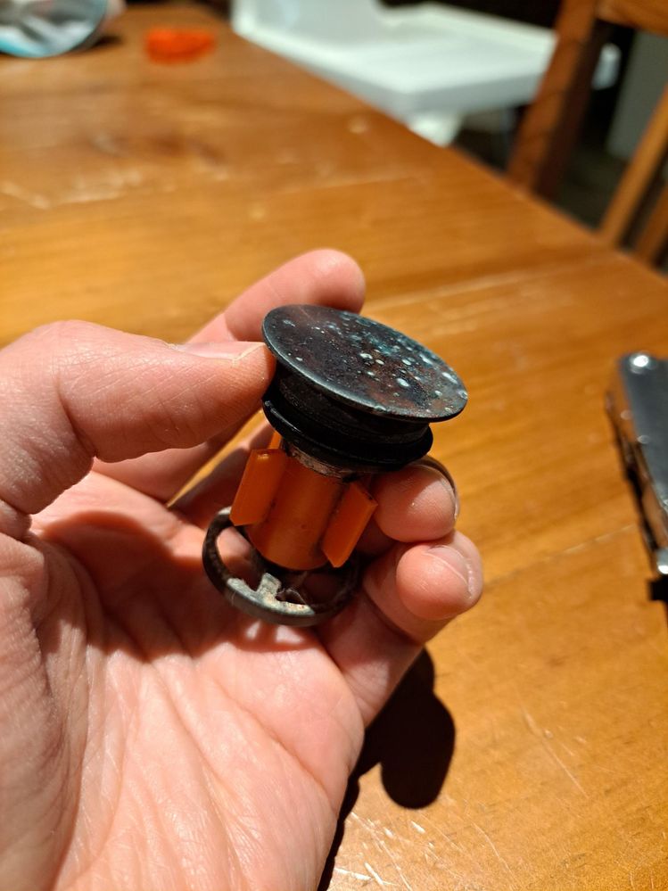

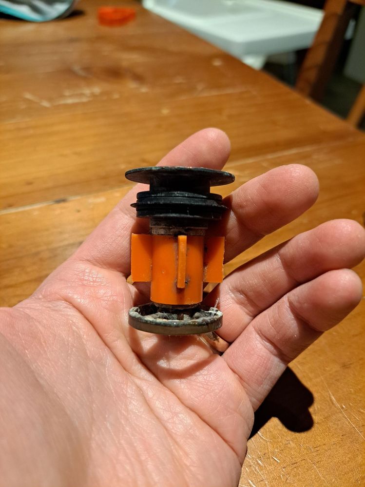

I'm hoping a plumbing wizard can help me find the product or solution I need. My pop up bath tub waste has siezed up with corrosion. I need to replace it but I'm struggling to find out what product it is. Google lens hasn't been any help in this regard.
Can someone out there recognise it and help point me to replacement or alternative solution?

Thanks for your suggestion Eric.
I was able to take the old waste plug apart and replace it's core with a new Kinetic Brass Pop Up Waste Mechanism
Now it works well. I just need to find a new rubber washer with a flange to replace the old cracked one.
