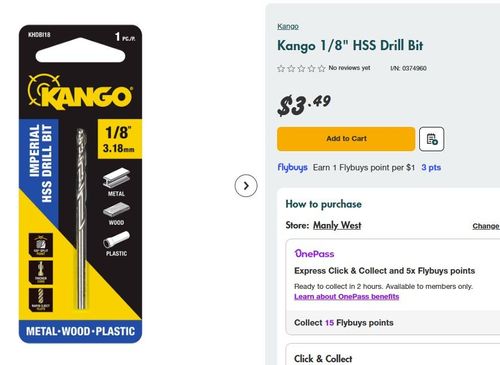

Hi @alexreed092,
I just want to pass on a pop rivet tip.
I recommend even for a one-off job you purchase a good quality HSS drill bit.
Kango HSS Drill Bit, and also a 5/32" drill bit.
A 1/8th bit from a DIY HSS drill bit set will likely struggle drilling out those pops - sometimes even one pop.
