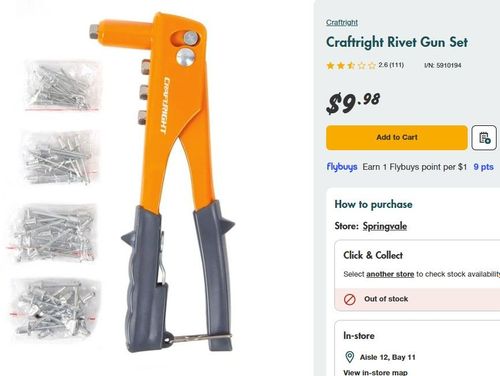

As @MitchellMc suggested you will need to use the same size pops with a pop riveter.
I have sold... sorry recommended that one and many people have tapped a reminder into their phone to get one 🙂
