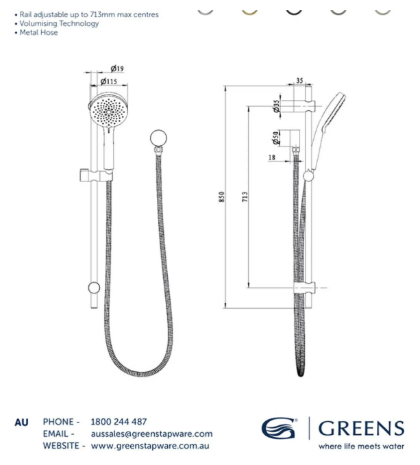

The only unit I found that was adjustable and is capable of meeting your current post distance is the Greens Australia Scandi Rail Shower Chrome. It is an online product and can only be ordered from the Bunnings website. I've placed the diagram below to give you an idea of how tall it is, and the amount of adjustment it can provide.

Thanks. Your website lists in features "Rail adjustable up to 713mm max centres" and shows 713mm on the diagram. I need 745mm. Will it do that?
Re: Replacement shower rail
I'm so sorry @Simon4, but it appears that the suggested rail does not extend to your required size. The mounting points would likely barely cover your previous holes, but you'd need to drill new mounting holes. That being said, it's unlikely you'll find a unit that is adjustable to your required size while also maintaining the same hole configuration, allowing you to use the existing holes.

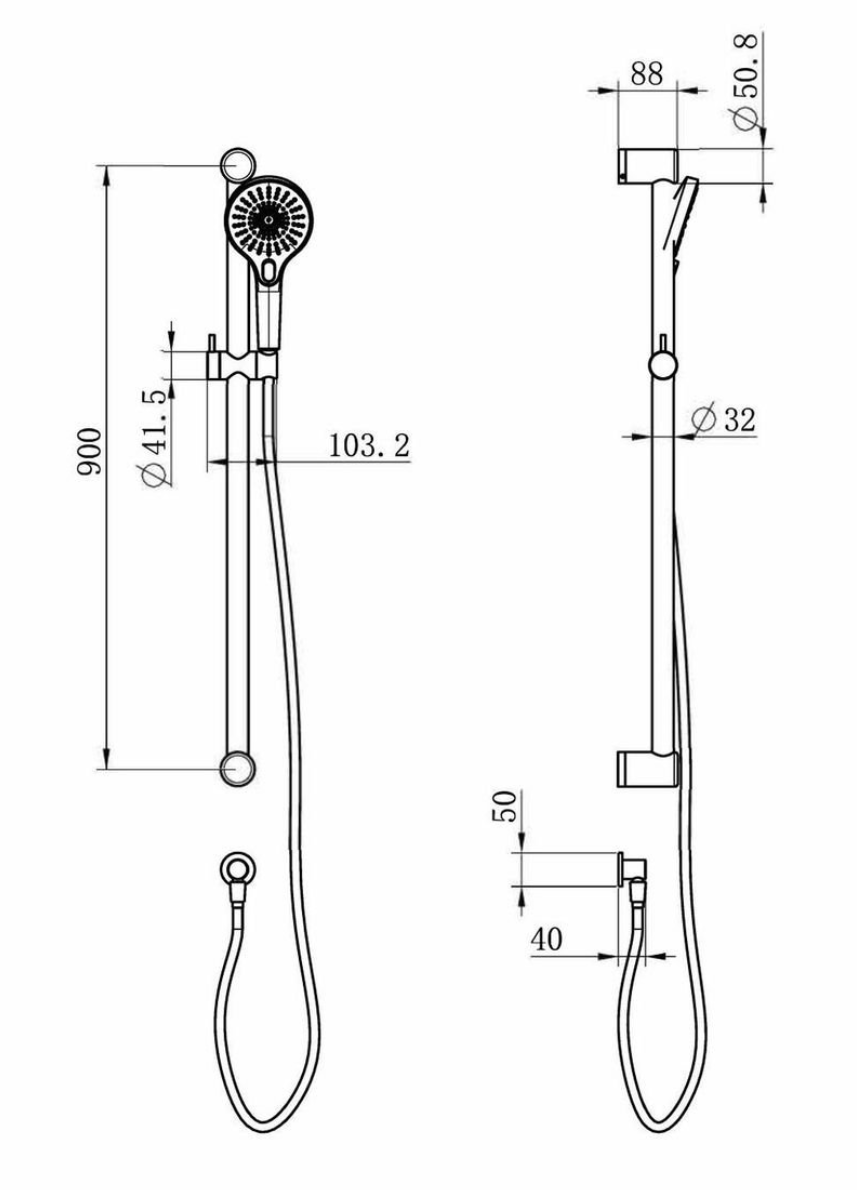

I've come across the Nero Mecca Care 32mm Grab Rail And Adjustable Shower Rail Set 900mm Chrome. It has a 900mm max centres and states in the installation instructions that it can be cut down to suit a shorter size, such as your 745mm centres.
