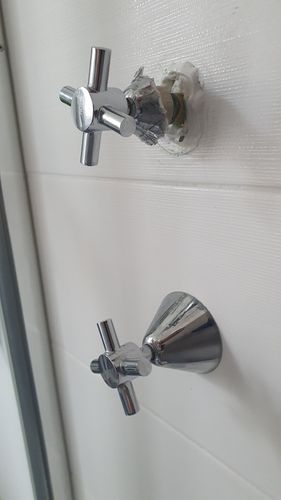

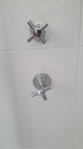

I can not remove these taps for the life of me any help much appreciated

The locking mechanism for your tap handles is actually located behind the handle itself. You'll need to use a Kinetic Spout And Handle Repair Kit. The tool is a flat blade with two prongs at the end of it. They fit into the two slots at the back of the tap handle. I've placed an image below to give you an idea of the location of the hidden brass lock.
The good news is that you can replace the flange with Shaw & Mason Chrome Brass Basin Cone Style Flange.
Please keep us updated with your progress, we look forward to seeing your taps repaired.
Thank you got it all replaced with that appreciate it.
