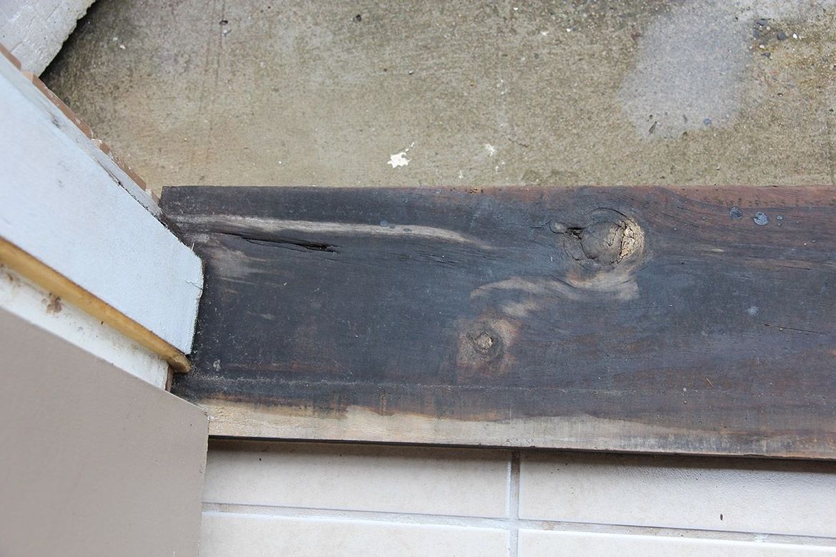

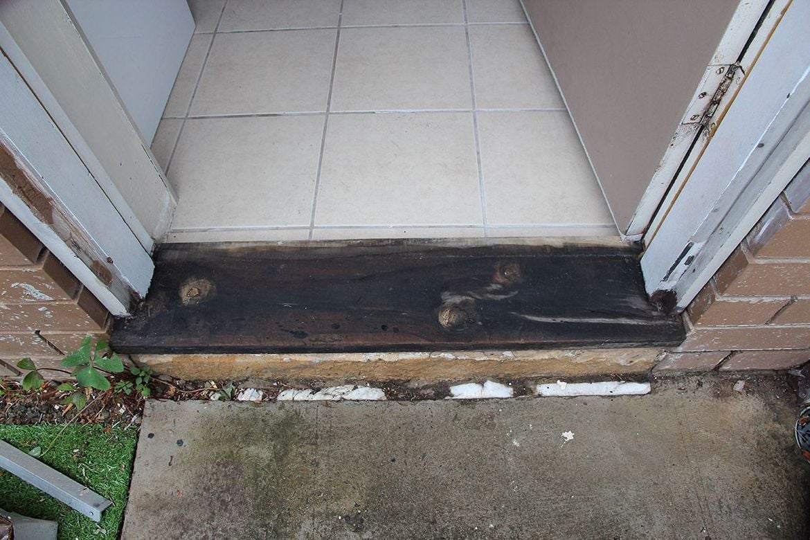

Hello everyone,
I am looking for some recommendations or ideas on how to replace an external laundry door threshold/sill.
I attached few photos. As you can see on the photos, it is completely damaged and rotten.
Because it is an external door, it is always exposed to rain. When it gets wet, it expands which makes it difficult to open or close the door.
I am looking for some solution that would be weather resistant.
What type of timber would you recommend to use? Does it need to be treated to make waterproof and what product to use? What paint would you recommend?
I am afraid that using timber, I will end up in a similar situation several years later and it will rot again.
So, I am wondering if there are some other products I can use instead of timber, for example, stone, tiles, metal, etc.

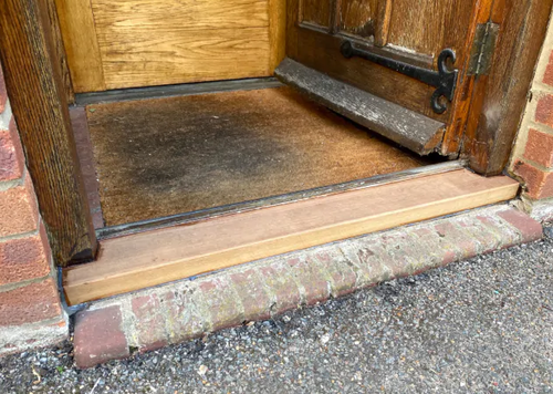

Looking at your image, the timber used on your threshold doesn't look up to the task. Sills need to be sloped so the water will run off and away from the house. Yours appears to be installed level, meaning water will not run off as it should. This, combined with the knots in the timber will allow water to seep into the timber, causing swelling and rot over time.
Timber is fine for use in this application, but the right kind of timber is essential to prevent this swelling and rot. Use hardwoods like Merbau or Blackbutt, as these are more resistant to rot and weather exposure. Protect the timber with oil, varnish or durable exterior paint.
There are timber profiles, such as a French sill, that are often made using hardwood and are designed for this specific purpose with the slope cut into the timber. See the below image as an example.

It may not be clear when looking at my images, but I have two doors in my laundry. One of them is visible on the picture and opens inwards. Other one is a metal security screen door which opens outwards.

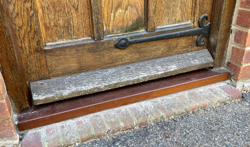

The timber on your sill looks like treated pine thats been incorrectly utilised as a sill. As @JacobZ mentioned it isn't profiled correctly with no fall towards the outside, which has added to its deterioration. It's also much deeper than standard hence why you're unable to find a matching replacement size. It's normal for the brick/concrete along the front edge to be exposed past the depth of the sill. Have a look at some sills on friends or neighbours homes to get a better understanding. I've included below some images though not French sill, but may also help.
You will be able to easily source a suitable French Sill in Merbau as @JacobZ recommended. Though you can paint it, I would highly recommend using a good quality water based exterior like this one from Cabots, which will come up a treat and last a lot longer than a painted surface.

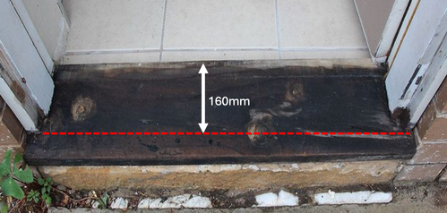

I think it would look a bit odd for the brick/concrete along the front edge to be exposed past the depth of the sill. If I install a 160 mm sill as @JacobZ recommended, I would have about 30-40 mm of brick/concrete exposed and it is hard to tell what condition it is in after I remove the old sill. Would it be Ok to cover the exposed area with some stone or tiles, or piece of hardwood board? Are there any recommendations?

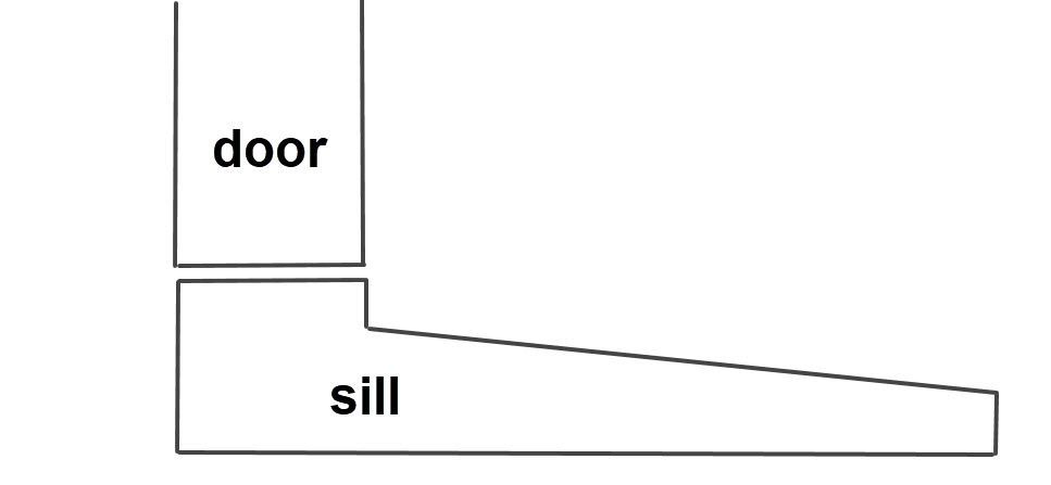

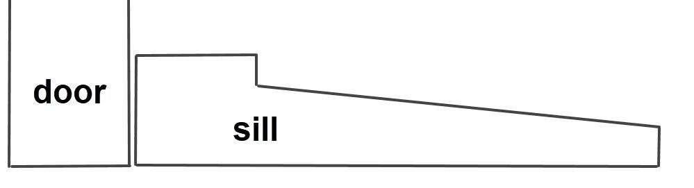

Please advise the correct way of installing the new sill. Which one is correct, picture 1 or picture 2 ?
Hi @alex27 It's the first one mate.

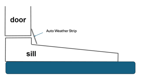

Below is the profile how it would sit on the opening. The lip at the top of the sill helps to prevent water blowing up under the door, but not great. So I always install one of these automatic weather strips. They come in a few different colours to and take about 15-20min to fit.
Again it's normal to have the exposed brick/concrete past the sill. I'll try and get a better photo today of what it looks like. We will get a better idea once the old one is removed as to what it looks like exposed. But timber won't be the option or tiles. You could render the exposed area and paint it, which might come up to something you like and durable.

As @Nailbag has mentioned, there is no reason you couldn't have the french sill sit back an extra 40mm from the edge of the concrete.
You could then render, tile or paint the exposed concrete to protect and beautify it.

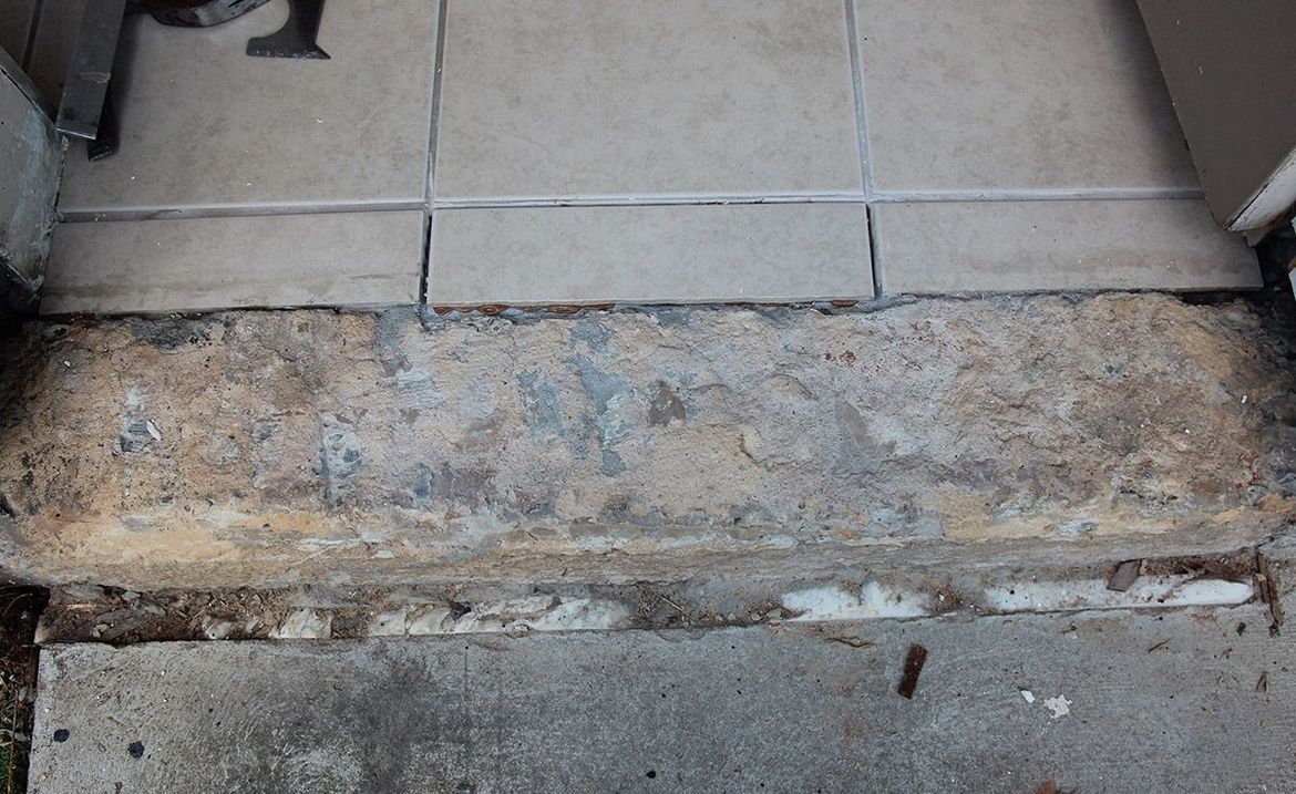

Thanks everyone for your advice.
I have purchased the following sill
This is what it looks like after removing the old sill
Please advice what type of adhesive to use to glue the new sill. Would Selleys 350g Heavy Duty Liquid Nails work?
Evening @alex27
Nice work in sourcing the sill and prepping the area. I think it would be wis eto continue removing some of that mortar that is on the threshhold tho. Kind of make it as smooth and levelk as possible will make it easy to seat the actuall sill.
You could use a cold chisel and hammer to slowly work away at the mortar. Is that a sandstone block underneath by any chance?
Liquid nails would work but Id wait just to make sure for some other confirmations from @JacobZ and @Nailbag as I havnt done a sill from scratch before. ![]()
