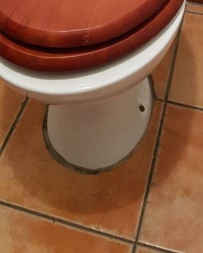

I am planning to change my toilet suite without changing my tiles. The current installation cut a hole in the tiles and I am trying to find a toilet which can fit over the profile and not leave any mark of the previous installation. However, the search proves futile. The width of the base is 24cm including the cement bit. The front of the base to the back of the wall skirting is 55cm (57cm to the wall).
Some questions
1. Do you have a recommendation of something that can fit this profile?
2. Is there any suggestion to minimise the ugliness of the previous installation if I get something that is slightly smaller?
3. For walls with skirtings, Can Wall Flush type be used? This means that the skirting has to be cut off. Is this advisable?
It seems quite a headache if you want to reinstall without doing a major overhaul, but yet want to retain some aesthetics.

Hi @andrewjd,
I recommend you take a look at the Stylus range of close-coupled toilet suites. The majority of their bases are 248mm wide and extend 665mm from the wall, so this should suit your needs. The waste outlet centre is at 140mm from the wall, but there are offset connectors available.
@PlumbMaster-Zee has provided some excellent advice on your other questions.
You might like to take advantage of our Toilet Installation offer. Simply select a front-of-wall toilet and arrange the installation in-store or online. The service includes installing all fixtures and removing the old toilet, and it is performed by a licensed tradesperson and comes with a one-year warranty.

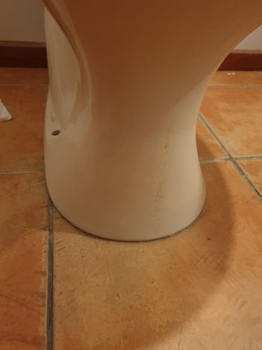

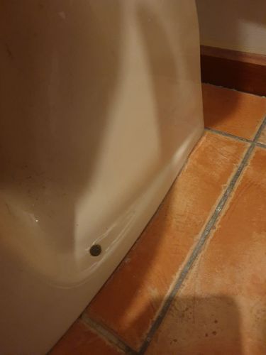

Thanks for the reply. I have another question. Just by looking at the photos, are we able to know if this toilet was fitted without hacking up the floor. I mean can I just remove the toilet pan. Clean up and then reinstall the new toilet without worrying about the tile?
It doesn't give the dimensions of the base. And should I be worried about the very poor reviews?
Hello @andrewjd
Thanks for sharing those extra photos of your toilet suite. Looking closely at the photos, it appears that the tiles go under the toilet pan and not over it. Therefore, if the pan is removed carefully damage to your existing tiles should be minimal.
I suggest measuring the width and length of your existing pan footprint. Another thing you can do is to do a cardboard cutout of the footprint and bring it with you to the store to compare it to the toilets on display. There are a number of toilet suites with large footprints and better reviews, I suggest looking carefully and see which one calls out to you.
