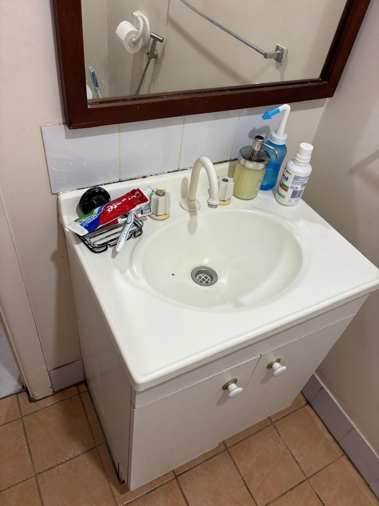

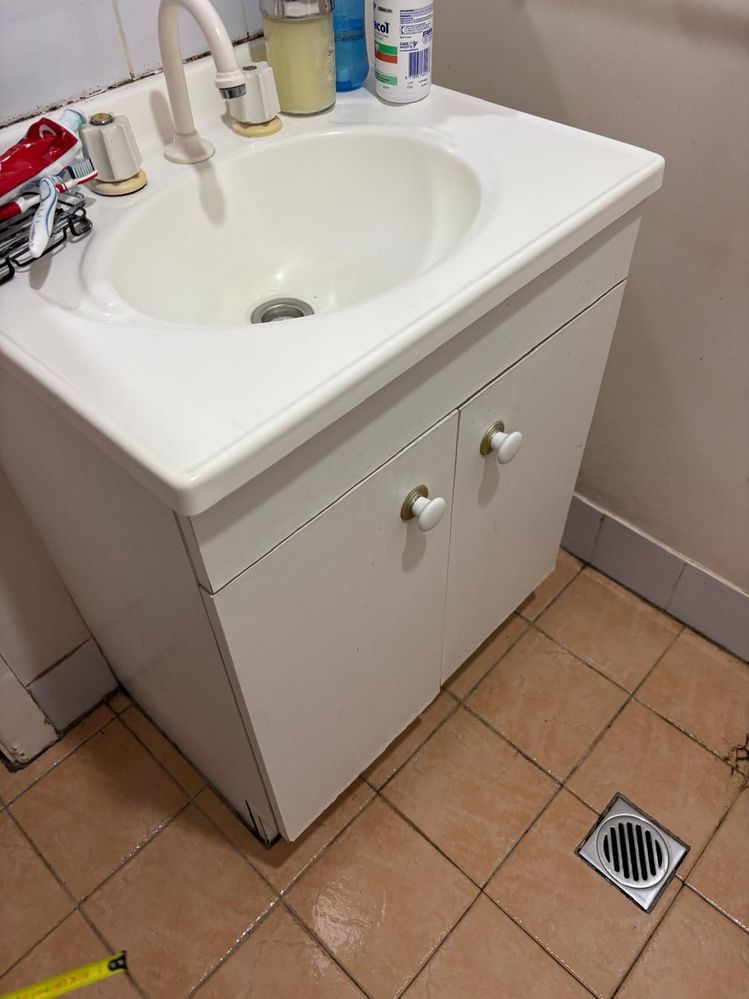

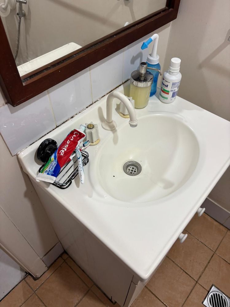

Dear All
Our basin is type of plastic not ceramic I am looking to replace it with a good ceramic quality one like Caroma ,,,,may be there are other brands
Can I find a Caroma basin to replace the existing one ? if not can I find a vanity with a ceramic basin ?
Dimension for the current
WhatsApp Image 2026-01-10 at 1.27.34 PM (1).jpegWhatsApp Image 2026-01-10 at 1.27.34 PM (2).jpegWhatsApp Image 2026-01-10 at 1.27.34 PM (3).jpeg
basin is 460mm x 600mm

I've had a quick look at the Caroma ceramic tops and there may be one or two that can be used as a replacement set, but it would require a lot of modification to your existing cabinet. An easy replacement piece I would like to suggest is the Mondella Rococo 600mm Ceramic Vanity Basin With 1 Tap Hole - 600mm and although the measurements are ideal, I would still recommend doing a test fit just to make sure the ceramic basin top sits properly on your vanity cabinet.

Since Mondella has one hole means we need another two holes for cold and hot water taps

The vanity top can be ordered with three holes if that is what you need. However, it is a good opportunity to upgrade your tapware from the traditional hot and cold tap to a single modern mixer.
