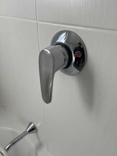

Hello Team, I’m planning to refresh my bathrooms with new tapware and some other things. I asked a quote to my local plumber and I was told in order to change the wall mixer in the 2 showers and bath I have to brake the wall behind the mixer to access it and replace it.
Is it that the case? Can’t I just replace the old mixer with a new one?

he inspected the mixer yes. Is explanation was that the new mixer cartridge and fitting won’t work with the T pipe inside the wall. It’s hard to believe that to replace a 5 years old wall mixer with an other one I have to make a hole into the wall. The mixer will be a different colour. Our renovation is based on make the space a bit more appealing. There is nothing wrong with plumping or tiles. They just don’t fit our taste. I have pulled the mixer apart put I can’t remove the last bit that connect to the T. I need a bigger tool. Once I have the whole lot with me I can source and alternative that can fit the T pipe inside the wall.

If the issue is with how the mixer cartridge fits with the tee in the wall, then the answer would be, as you've said, to source an alternative that can fit the pipe.
Please remember that any alterations to the pipe itself will need to be done by a licensed plumber.

Essentially the plumber is correct as typically unless its the same brand and type of tap ware your replacing, the associated plumbing fittings are internal of the wall. It why when you're renovating a bathroom, you need the fixtures in the early stages for the plumber to install during his rough in.
The possible scenario you have discovered in being able to match both the cartridge and mixer ring thread. However from several experiences unfortunately the chances will be very slim as there are several other variables when it comes to fitting the external chrome cover and the mixer handle.
Then the other issue is not being able to take the required fittings with you to the various plumbing suppliers. so, it becomes potentially a lot of trial and error. But I hope you have success!

I have pulled apart the mixer the only part that I do not taken off is the part that connect with the T pipe inside the wall. Was surrounded by silicon and my wrench was too small for it.
my plan is to pull the mixer apart, then go hunting for a suitable replacement, install it and if all fits well go head and buy the rest of the mixers, faucet and shower heads to match that. From what I saw at Bunnings the T pipes are pretty much all the same.
