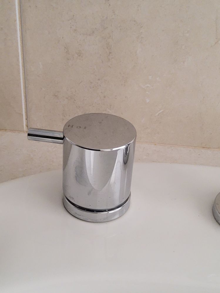

I currently have 2 Caroma basin taps that I need to replace.  I want to replace them with Caroma Luna basin taps because they are a similar size and look.
My question: can the Luna taps replace the Kytin taps without any plumbing work being required.?  I would prefer Kytin taps  but they are no longer manufactured.

I've just been in contact with the Caroma technical team, and they have confirmed that the Caroma WELS 5 Star 6L/min Chrome Lead Free Luna Lever Basin Tap Set is compatible with the Kytin spindles. Please note that the Luna basin set can only be ordered as a set and not as individual items.

Thanks for the information Eric.  You managed to have better luck contacting Caroma than I did.  Any time I mentioned Kytin they didn't want want to know me.
Today I managed to buy, from Bunnings Balcatta, a set of Luna basin taps without having to purchase the spout.  Only $139.
