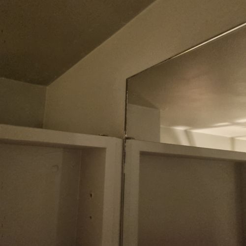

I would like to remove my bathroom mirror. It's a typical glued flat mirror seen in many cookie cutter style apartment bathrooms.
I googled and read up that wood flat shims should be used. I can't seem to find this product online. Could you recommend what I should use and do to remove my mirror safely.
Here's a picture of my mirror. It's 180cm x 80cm so fairly large.

There are a few reasons why I'd suggest you consider having a professional glacier remove this mirror. The first is that due to it being positioned hard up against the cabinet, you won't be able to get any shim behind it in that section to release the glue. The second is the overall size of the mirror, which will make the job very cumbersome once the glass is released. And finally is the potential for this mirror to break in the process. If it's an older mirror, it might not be safety glass, and if it shatters in the process, you could be injured by large shards of glass.
I suspect a professional would start by either blocking up under the glass to hold its weight or having a helper secure it with a suction cup. They'd then likely heat the mirror up to soften the glue/silicon holding it in place. They'd lift a corner only enough with paint scrapers or custom-made wood wedges to feed a wire-rope cutting tool behind it. They'd then use this tool to saw through the glue/silicon.
You could place wooden wedges around the mirror's perimeter and have it successfully pop off if it wasn't glued on particularly well. However, I believe there is a high likelihood that the mirror will shatter in this process. I'd recommend you phone a few glaziers and get quotes on the removal.
