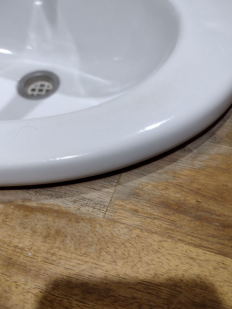

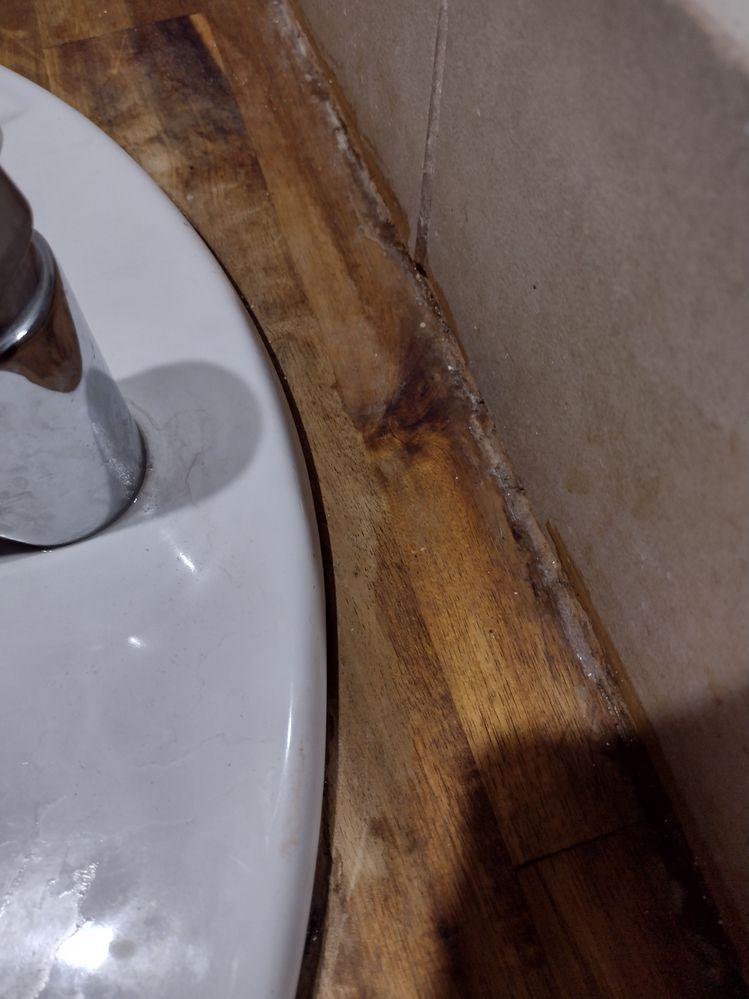

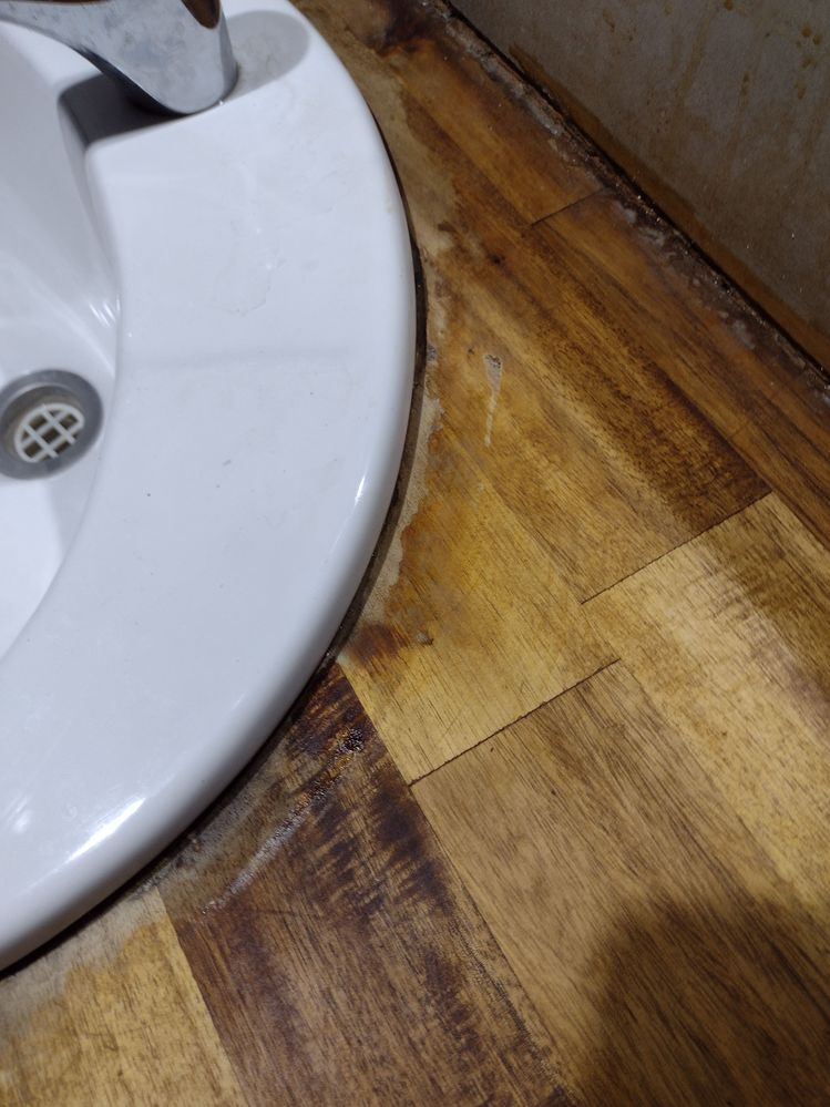

Hi Mitchell
Here are some pics of the new basin.There is a 12mm stain left from the old one. I'd like to use a surround or tape to avoid having to sand, fill and re-coat the vanity top.
thanks.
Hi @nicherbs,
Thanks for those images. It now sounds like you are referring to the uncoated section on the bench. There is no surround tape that I am aware of. Typically in such situations, you'd touch up the areas by applying another coat of a similar sealer to what had previously been used. It looks like it was potentially some type of benchtop oil instead of a hard varnish coating. I'd recommend you do your first touchup coat on only the raw timber that has been exposed and then follow up by recoating the entire bench. No need to sand as you might find the two timber areas blend well together.

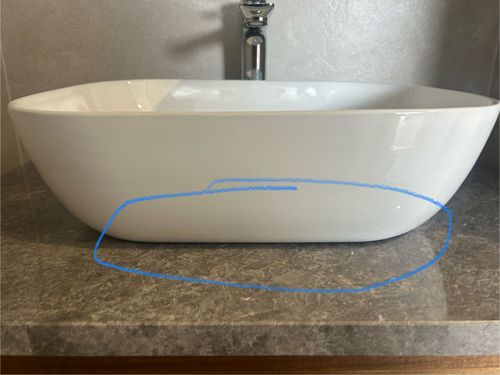

What are the silicone fillers that could be used to fill this space between a newly installed washbasin bowl and the marble benchtop.As this difficult to clean area around the basin could be a breeding ground for mould as I live in a humid part of QLD ? The builder renovater said it is hard to fill without damaging the looks
someone suggested this - any ideas as to how to fill in the gaps without damaging the marble bench top in the process ?
Hi @Aanya,
A translucent or white neutral-cure silicone like SikaSeal Kitchen And Bathroom Silicone Sealant or the one you've photographed is fine for this job.
Applying a smooth, consistent bead of silicone to cover the gap will prevent water entry and mould growth and will not damage the marble in the process.
Check out How To Silicone a Gap for some guidance on the process.
