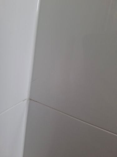

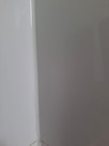

After completing my silicin re-seal I've found a light but noticeable scratch on a section of wall tile. Its light, as in my finger nail doesnt feel it
when scratched, but I wanted to see how I could seal it. Ive used clear and white wet area Selleys and nothing seems to fill it/stick to it.
What am I missing, or am I waisting my time? Scartch seems to go behind the silicon in the joint.
Re: How to Seal Small Scratch In Shower Tile
Hi @Msteain,
It looks like it is just a light scratch in the glaze on the outside of the tile. Functionally, I doubt any water can pass through it, so it really is just an aesthetic issue.
If you could put up with it, I don't think there's any issues that would arise from it, but if you can't stand looking at it, which I completely understand, I'd suggest using this Rust-Oleum 13.3ml White Tub And Tile Touch Up Kit.
It is a two part epoxy acrylic formula that is white in colour and perfect for wet areas. You could apply it to the crack to both seal and cover it for aesthetics.
