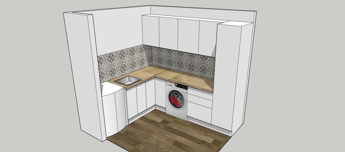

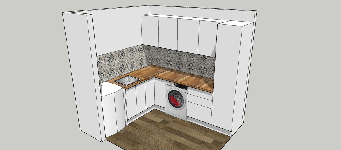

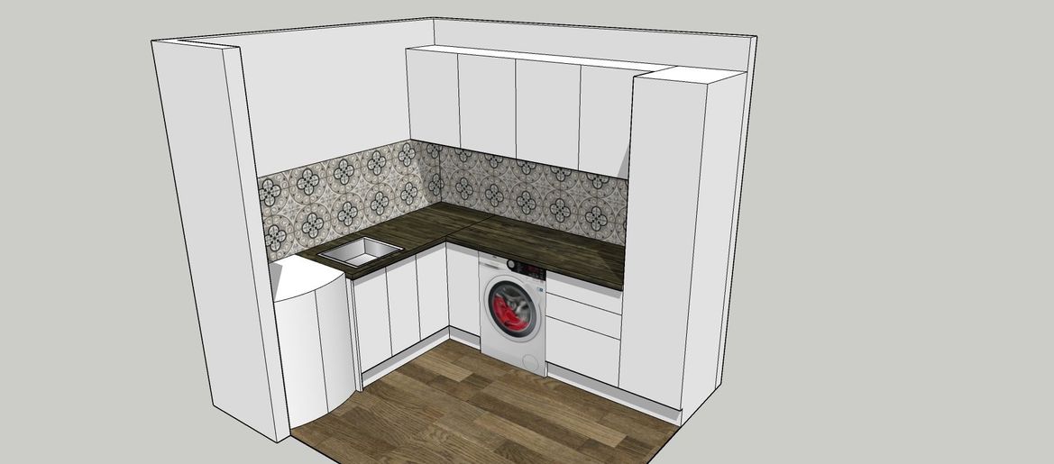

Hi @cathie12
I hope I'm not to late with the suggestions. But just in case you wanted to see what the benchtops might look like I've sketched up a couple of samples below to give you an idea. But if you've already chosen your benchtops, please enjoy the drawings.
Cathie12 laundry1.jpgCathie12 laundry2.jpgCathie12 laundry3.jpgCathie12 laundry5.jpg
