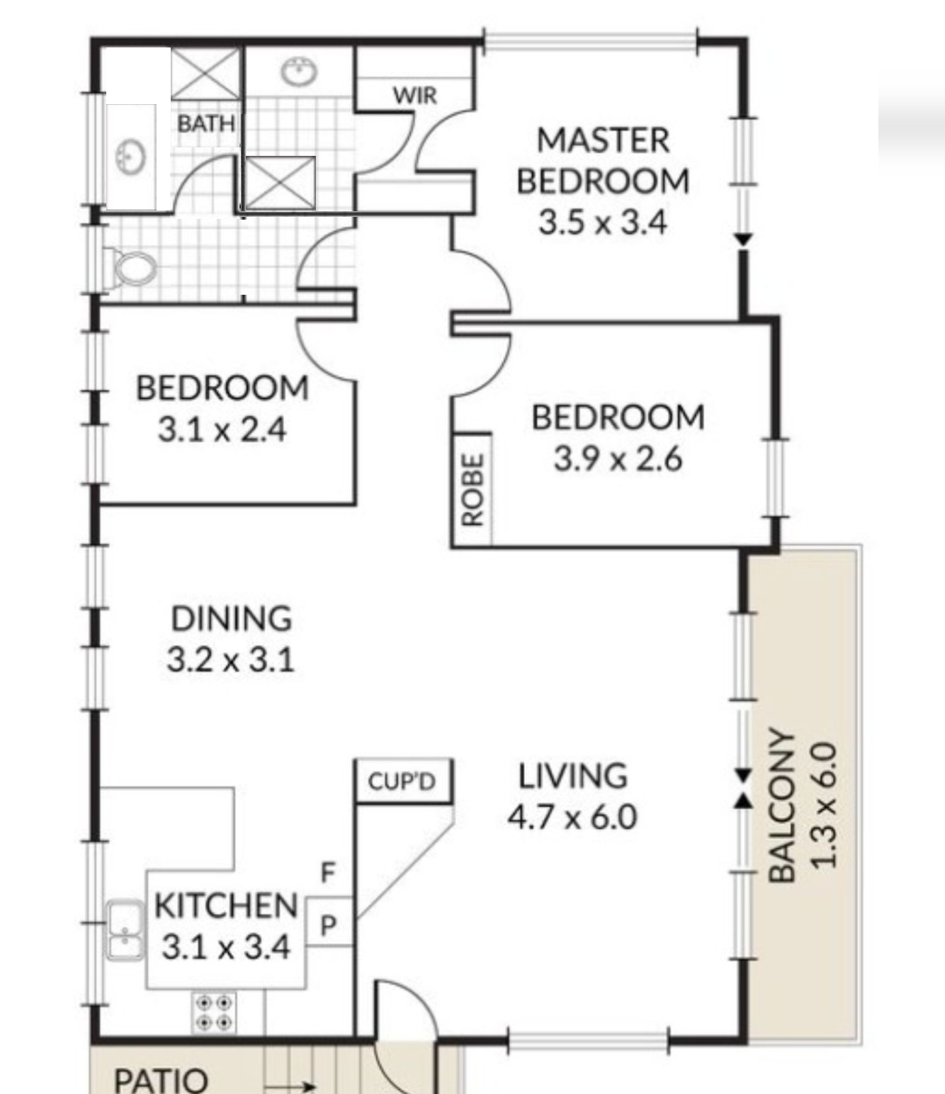

Hi I am new here and first home. Can someone please provide the ideas on how can I achieve an ensuite and a main bathroom.i just need showers no bath, any help would be appreciated
I am just stuck because of the window, I was thinking to divide the bath into 2 to get 2 showers ..

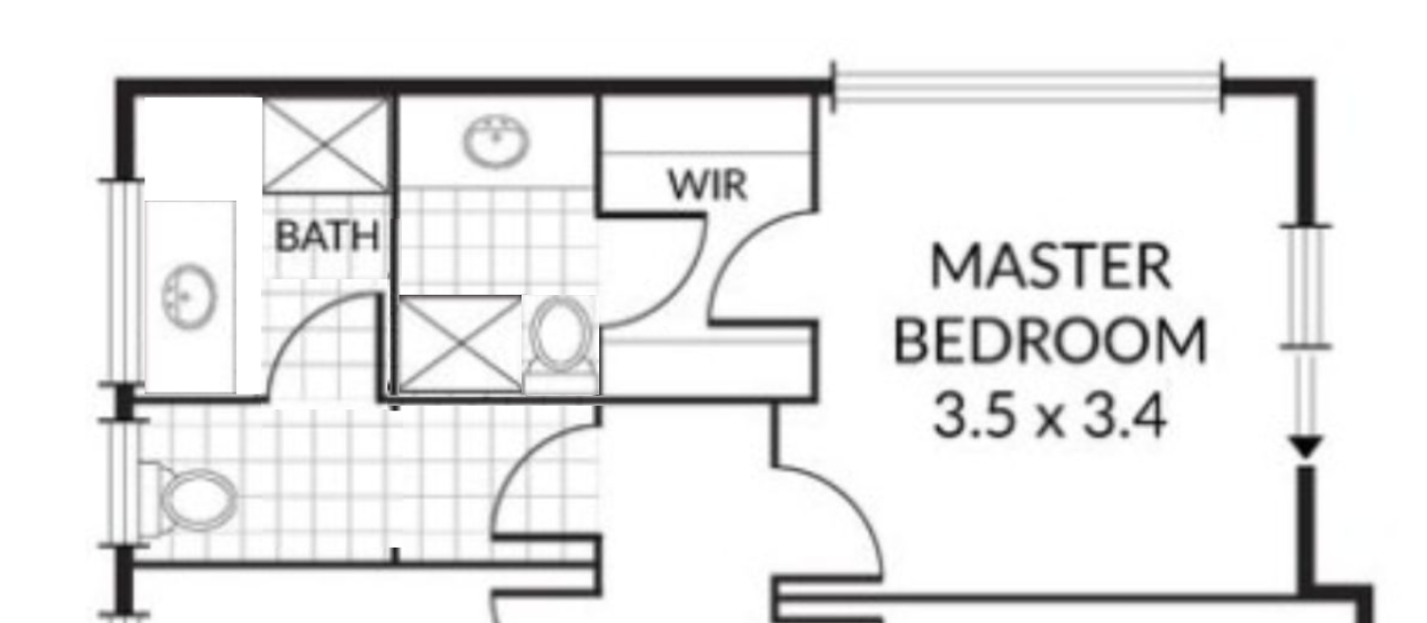

Thanks for sharing your floor plan. It sounds like you’re looking to create both an ensuite for the master bedroom and a main bathroom with just showers. I just wanted to clarify a couple of things before offering detailed advice. Is there currently a shower in the existing bathroom, or is it just a bath? Also, are you willing to remove the existing bath if needed?
I’ve edited your image to show one possible way of dividing the space to get two showers, assuming the window placement and plumbing allow it. If you can provide a bit more detail about your requirements and what changes you’re open to, it will help our members give you more accurate and practical suggestions.

Yes there is a shower next to the bath where X is shown.i don't want bath but ensuite with shower and toilet+ main bathroom with shower and toilet. I am concerned about the window because i am not sure how I can do water proof it or is there other way. Thanks in advance

It appears you have enough room for what you are intending; it's just an awkward layout. Due to the current layout, you might find it easiest to start again with the space, add walls and doors where needed to divide the area into two separate bathrooms.

This couple of suggested layouts by @MitchellMc @provide and excellent start making use of very tiny spaces.
But to make the most of it, I would consider his comment to start fresh, which is most likely going to be required anyway for a number of construction reasons.
I would also incorporate the toilet into the main bathroom as you will gain even more valuable real estate.
