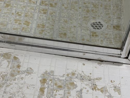

I’ve just moved into a new property. The previous owner has “renovated” the bathroom, there are a few issues. One being water is leaking outside the shower and pooling by the outside of the shower door. I think I may need to add a seal or sweep of some sort, but everything I google seems to be for glass doors that aren’t framed. There is no rubber or sealing in the underside of the framed door. I hope that makes sense. Any guidance on this would be so appreciated. Thank you.

I am unsure about what type of seal would be used, however I would take an overall photo of your frame and maybe one or two closer ones in of the curves that are part of the door and head into a shower screen/bathroom place to see if they recognise the brand or model even. Trying to work out how its been put together will show if a seal or a silastic of some kind has been used.
Is the right hand side of the opening raised a little compared to the left? Im not sure from the photo. If it is there could be some form or corrosion also pushing it up.

Thanks Dave. I don’t think it’s raised on one side. I’ll do as you suggest and see if I can find someone who can recognise the frame. Thanks again.

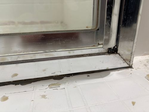

I doubt you will find an off the shelf deflector, which you are already discovering due to the door glass being framed. This is because the door swings within the opening frame and the has a lip all the way around when the door is closed.
It's possible that the silicone/seal holding the door glass to its frame has deteriorated, and/or  sections of the opening frame.
If you were to look edgeways at the door when closed, which of the two images below would be the scenario? It should be "B" . But it its A, then a vertical metal strip will need to be fastened in front along the bottom door opening frame and siliconed to replicate what it would be like.

I might need to get a handyman out as this is all beyond me I think. I think the door is A, there is a gap when the door is closed.
