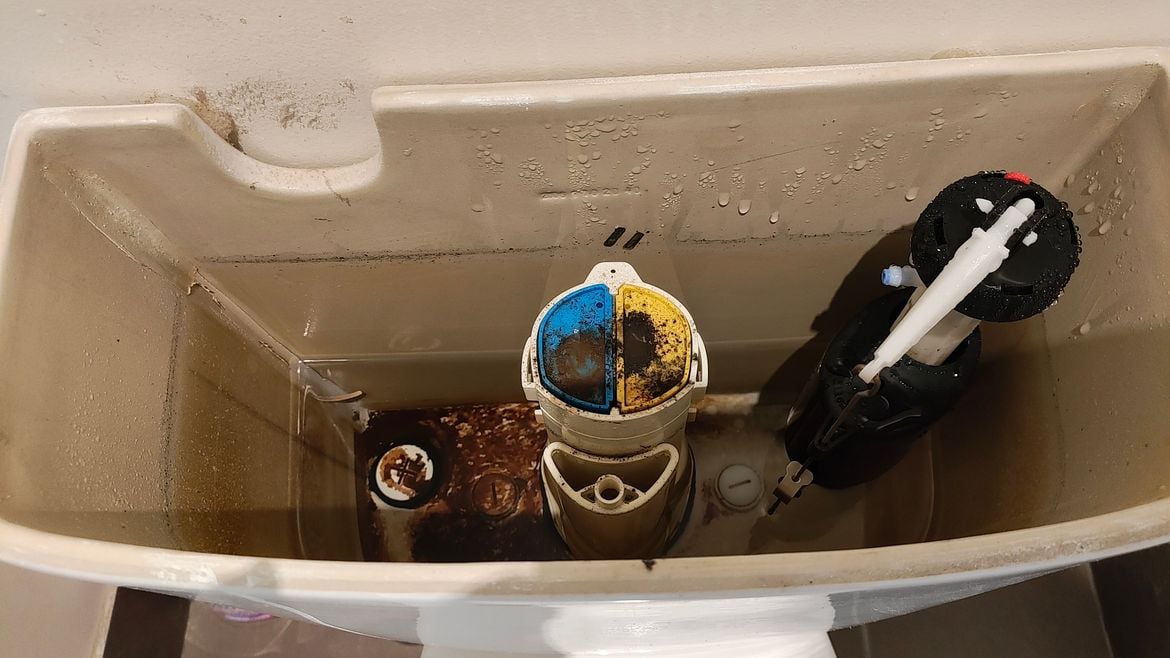

How the toilet looks inside. Side note: Can anyone tell me why one side is clean and one side isn't?

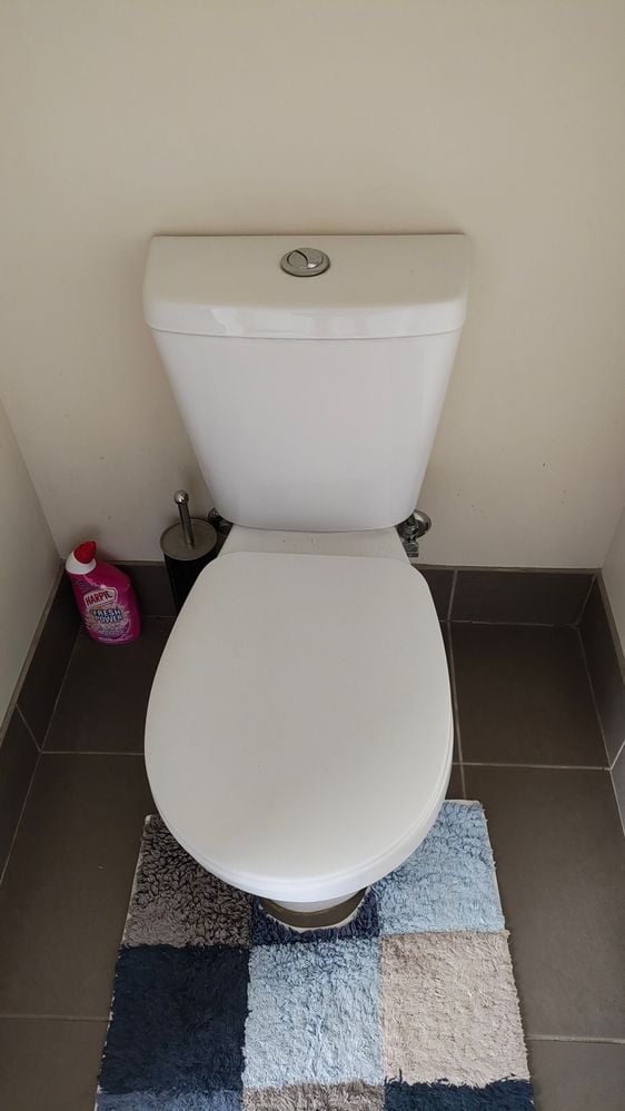

How the overall toilet looks

As for why one side of the toilet bowl is cleaner than the other, this is usually due to the way water flows into the bowl. The side receiving more direct water flow, which in your case is the side closest to the inlet valve, stays cleaner, while the other side accumulates grime or mineral buildup over time. This is a common occurrence, especially if the water doesn’t circulate evenly around the bowl.

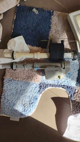

Looking on the website the replacement seal is $6 but I can replace the whole thing for $24. Given the reviews are better for the replacement, it seems like the better way to go.
Just wanted to confirm this is compatible with my cistern. It looks to be, but wanted to make sure before buying it:
https://www.bunnings.com.au/fluidmaster-bottom-entry-toilet-inlet-valve_p4926949
Alternatively this, because reviews seem better overall. The design is different, so just want to confirm it'll still work:
https://www.bunnings.com.au/kinetic-bottom-entry-inlet-valve_p4920265
Hi @Kalliste,
As you have a bottom inlet toilet, either of the options you have mentioned will work.

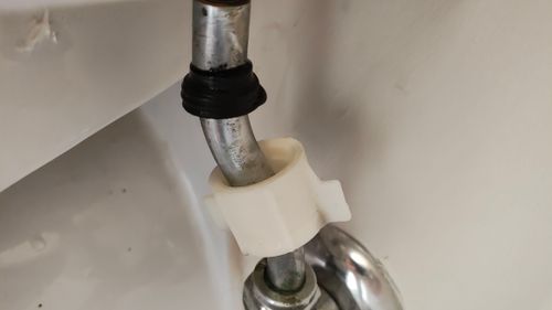

This black rubber that was already there is in the way. edit: I thought I could remove, but I'm guessing I'll need to move it so I can screw it back on. One thing is the rubber is pretty brittle. So, if it's something I need how do I go about replacing it?
