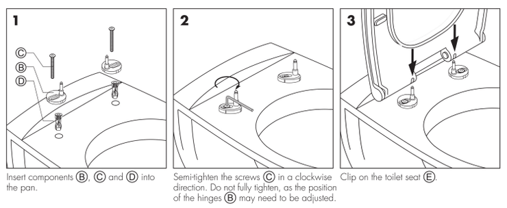

It looks very similar to the Mondella Rococo Rimless Back To Wall Toilet Suite WELS 4 Star 4.6L/Full. Can you please take a photo of the hinges of the toilet seat? This will give us a better idea of how it is attached to your toilet suite. It's possible that it has a push-to-release button that will allow you to access the hinge set of the toilet seat. I've placed a general diagram how the hinges are connected to your toilet pan.

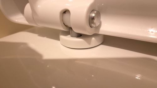

Re: Toilet seat questions
Here is the close-up it looks similar to what you have posted above.
Is it true that you cannot really adjust the toilet once it has been installed fully? It says do not fully tighten in the instructions but that would allow the toilet seat to move around laterally.
Hi @bara3,
I can only imagine a note about not tightening fully would also be accompanied by "until you have the seat positioned correctly". At that point, you should definitely tighten the fixings.
I think you should leave them loose, pop the seat on, align it on the pan, remove it, being careful not to rotate the fittings, tighten the fittings, pop the cover plates on and push the seat fully onto the spigots.
If you tighten the fitting before checking the seat alignment, the seat likely won't fit on, or it will be off centre.
