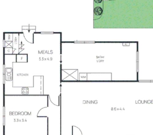

I love reading your advice and ideas with others in the community, and I have an idea for a renovation of my house that I would love to hear your idea on it.

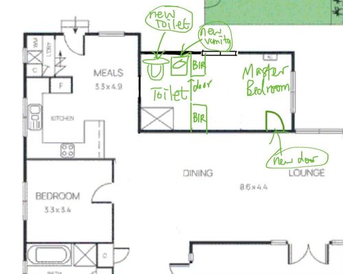

I have an unused laundry/ shower room in my house that I want to turn into a bedroom with en-suite. The room already has shower and laundry so there are water supply and outlet, and exhaust fan. I plan to open up a new door, likely loading wall, to make a more logical entrance and add a stud wall within the room to separate out the en-suite. I will need to add a toilet inside.
What do you think of the design? Any area of improvement? I’m new to renovation and it seems quite nonstandard job, how should I begin looking for trades to do it.
(The window location is correct in the mark up drawing so there’s no need to relocate the window)

Your proposed lay out looks very good, I suggest keeping the two wardrobes together and move the bathroom door to the other end. In this manner the light from the bathroom will not shine directly on the bed and avoid waking up anyone else sleeping on the bed. I also recommend using cavity sliding doors to maximize the use of space in both the bathroom and bedroom. My number one suggestion is to make sure to install a heat/fan/light combination appliance in your bathroom for effective ventilation.
Let me call on our experienced members @Dave-1, @AlanM52 and @Nailbag for their recommendations.

On the surface it all looks very doable, though there will be added costs/complication should the house be built on a slab. If it's on stumps with plenty of under-floor access then the project will be fairly straight forward.
You're most likely going to need a builder permits and plans drawn up etc. So, since you're intending to get this professionally built, I would look for a local registered builder who can offer a turn-key solution in renovations. They would be able to provide all the services from start to finish.
