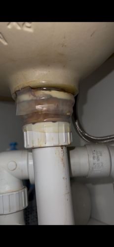

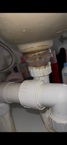

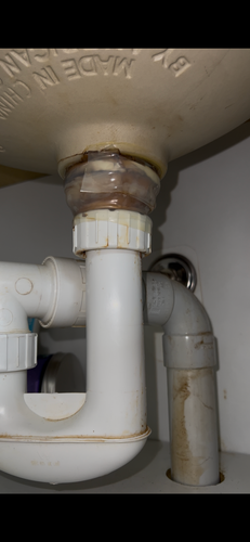

My bathroom sink doesn’t drain water and the level is sitting very close to the top. I’ve tried everything to unblock the drain including drain snakes and cleaner etc. I think the issue is a blockage in the u shaped pipe underneath. But I’m not sure what the previous owners of this house have done with the tape. Can I still clean the pipe with that plastic tape covered?

Thanks for sharing your question about your basin trap. The tape wrapped around the top is called the Tommy Tape 25mm x 3m Clear Self Fusing Silicone Tape and is used to stop leaks. I generally suggest using the drain snakes and chemical cleaners, but if none of these items have produced positive results, I suggest engaging the services of a registered plumber.
There is definitely something blocking the drain and I'm afraid regular troubleshooting is not going to solve it.

That is a DIY Fail-
Everything needs to be removed, cleaned, inspected and any damaged parts replaced and then correctly installed.
I suggest you engage a plumber to do the job.
Looks like they had a go at unblocking the trap and when replacing the pipe ended up at a angle and/or cross threaded the fitting, then tried the tape fix.
